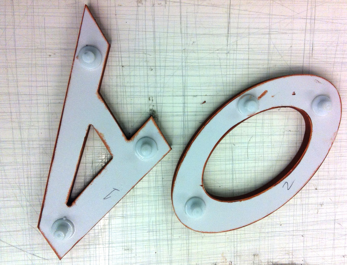

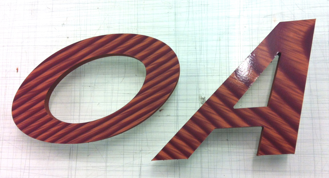

    Photoshop ‘eye candy’ wood on 10mm PVC with locators & painted sides.

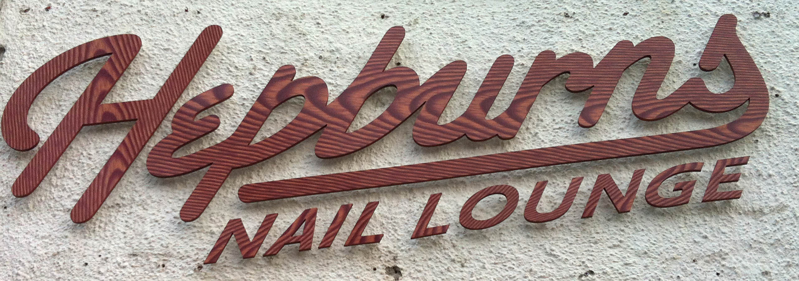

    Part of a large install for a St. Andrews nail & beauty bar.
    Looks really good in the flesh – photos just don’t do it just justice.
    Will upload finished job in due course…light permitting!

    The wall is in a sorry state, but they didn’t want to paint it before we installed.
    Client designed logo shape…

    I’ve done a few coated 10/19mm PVC letters – some with single colour vinyl, others reflective and others with digi print.
    SO far not suffered any edge lift or shrinkage that’s noticeable – and on past occasions I’ve been back to the signs up to 2 years later to relocate businesses. (flood coated black, painted black edges)
    Edges were painted off with a mixed acrylic paint (brown, red, yellow) to get the right shade. It’s water proof when dry and easily applied with a sponge to rub it on like wood stain rather than a thick painted on coating…overspill wipes off when wet so really easy although a bit time consuming.
    The signs are between 8 and 16 feet off the ground so a textured laminate effect probably wouldn’t make any more or less difference to the job.
    Finished it off when it was pitch black (working by the lights on the drills) and no mains power as client when home, so the other side that’s got a lot more going on will have to wait for a photo.
    I think it may be a product I’ll be pushing a bit more of – especially for indoor use (kid’s rooms / offices).

    My only gripe would be that the grain on the small lettering would have looked better if it went in the same direction as the main lettering.

    The customer specifically reqested that it didn’t look like it was all from the same piece of wood where possible and to not grain match.

    I note what you say about your customer’s instructions David, but I’d have to agree with Mike – I think it spoils a good job. The customer may have a valid reason for requesting it but it’s not obvious, and I think may reflect on you more so than on him, for anybody who doesn’t know the reason.

    The average person seeing it thinks it’s great and only a signmaker or the person paying for it will take note of the grain direction. If it ruins my reputation for my ability to produce fake wooden letters I suppose I’ll have to take solace from the couple of grand in my pocket 😀
