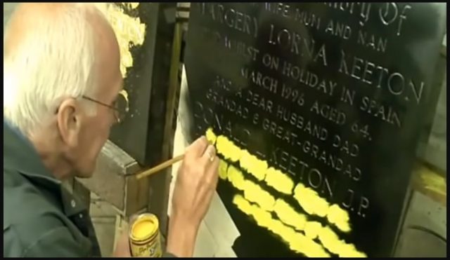

    A customer has asked me to refurbish an engraved black marble gravestone where the original gold infill has all but faded away.
    I’ve done this many times on engraved brass or silver plaques, but never on the marble.
    Any tips on what paint to use (I want to avoid leafing), and is there any special technique I should know about?

    We do quite a few grave markers & would always use Windsor & Newton Acrylic gold – Series 3. This seems to be very outdoor durable & have not had any problems with it. I use a sponge & rub the paint into the marble in circular motions. Be liberal with the paint. Then I use a stainless steel blade to remove any excess paint. When it’s dry, I use the blade again to remove paint from the face of the marble, now you’re left with your new gold lettering.

    We always use oneshot enamels, again have been very reliable and durable outdoors.
    Providing there is a polished surface on the stone, slap the gold in the letters as described above but then when its completely dry (48 hours or so) go over any overspill with a cuttlefish bone. Its tough enough to remove the excess paint but wont damage the polished surface. I know its sounds far fetched but I picked this tip up from a brush guy and it works….. really!

    One-shot would be much better. I have done these and a quick wipe up to the edge of the letters with a cloth wrapped tightly over your thumb means you don’t have to go back. Just move the cloth a small bit each time to get to a clean bit. Hope that makes sense.
