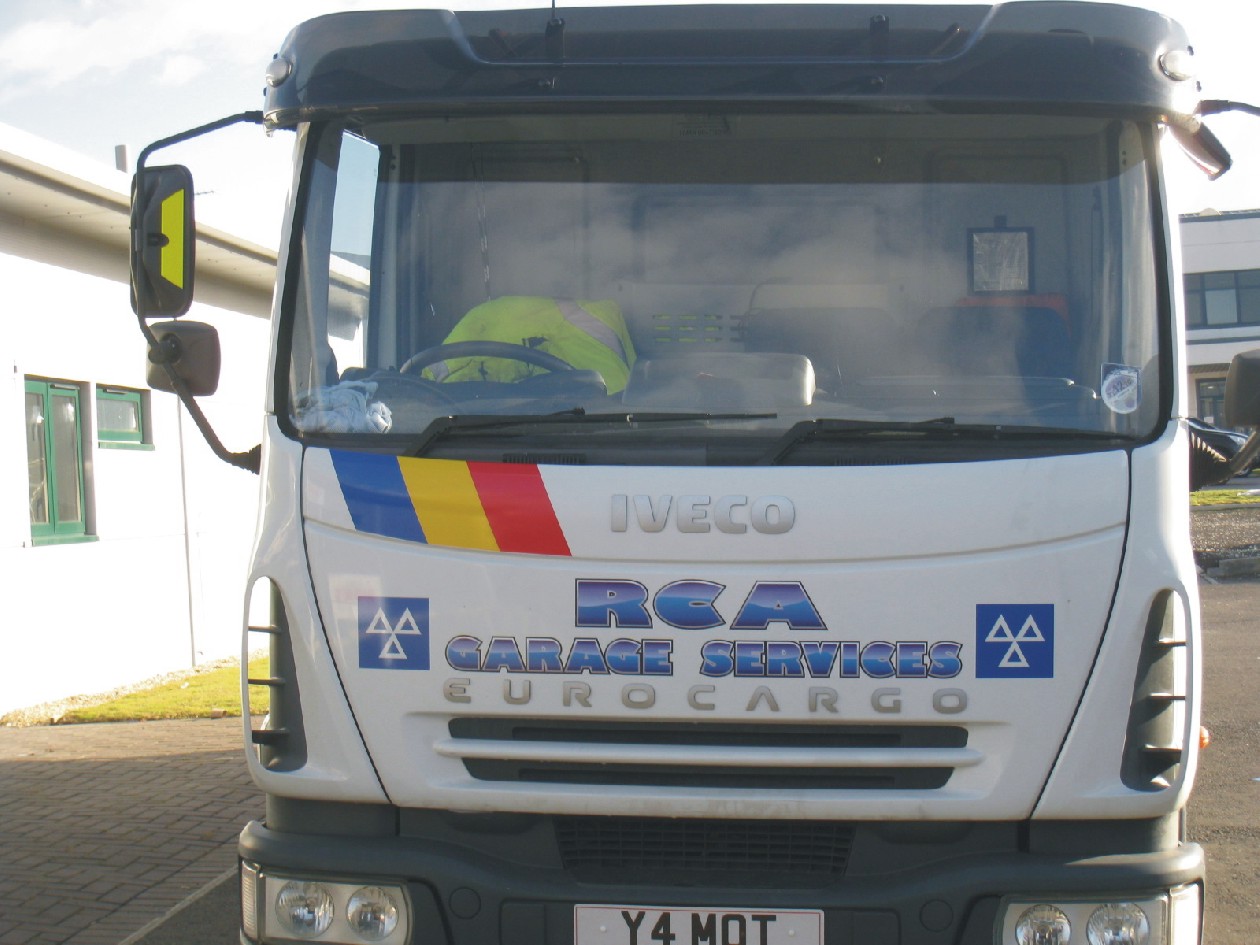

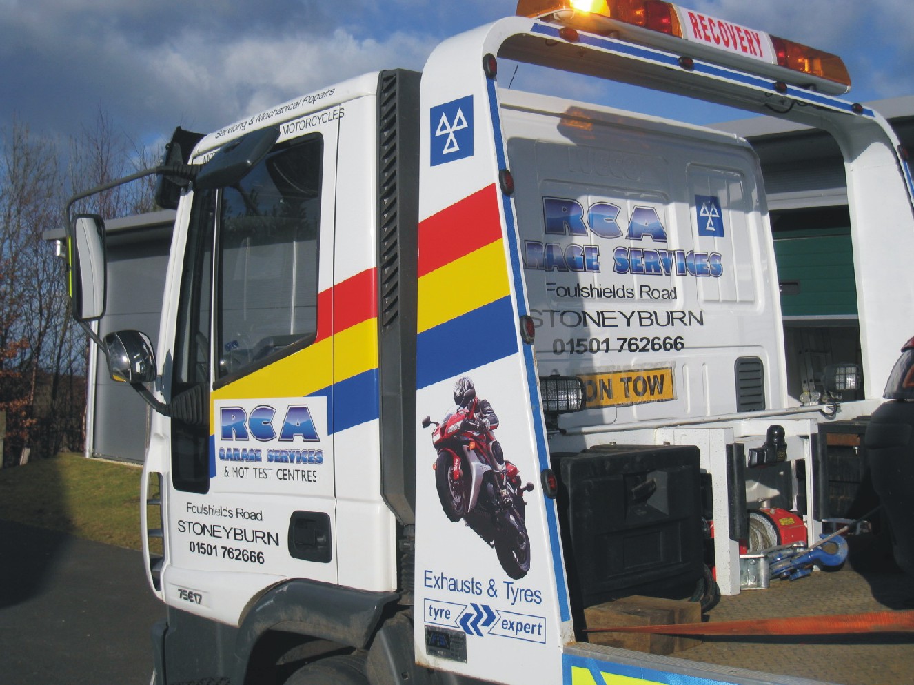

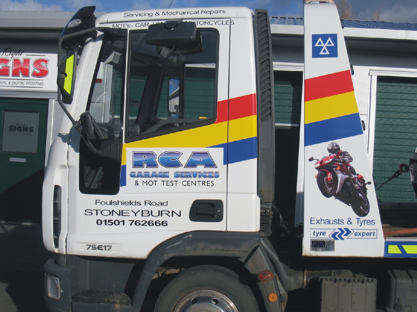

    Did this today. It’s a combination of digital print and cut, and conventional cut vinyl. The stripes were applied first, then these were trimmed to expose the white background into which the company name could be fitted. The easy way to do it would have been to print the logo onto a white background and overlay this over the strips but I wanted to avoid ridges where one layer of vinyl overlapped another.
