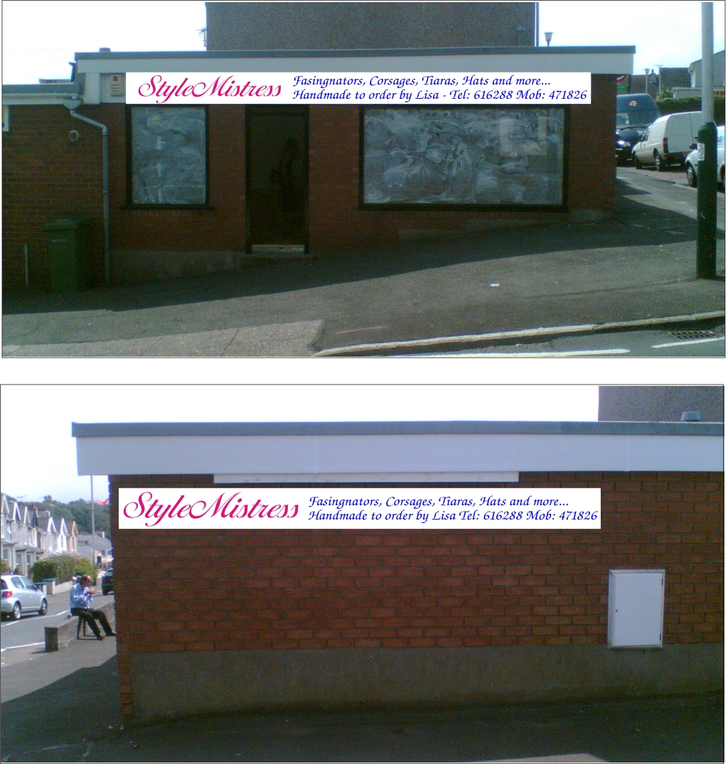

    Just got a job i need a little help with. Customer has asked for part of the sign to be raised/located lettering which is a job I havent as yet tackled since starting. So basically i need a supplier that could manufacture the lettering with i assume a plan for fixing the mounts in the right places. The rest of the sign is just foam panels and vinyl.

    Looking at the lettering on the sign, I would avoid using acrylic. Especially if all the writing is joined, as it is going to be difficult to handle without breaking. I had some made in Reynobond recently and they looked a treat, as long as you don’t mind the different coloured edge.
    Also, one of your signs looks rather close to the ground. Are you worried about vandalism?

    Good point! I’d not really thought about vandalism, could become a nightmare at that height. I think i’ll suggest doing the low one in just vinyl. Thanks for your help and ideas Andy.

    Re: your sign. I would use a less extravagant font for the descriptive text and tel no. It detracts from the stylish font you have used for the name and also looks very cramped and hard to read.

    I know what you’re saying about the fonts but it was the customers choice as she’s had all her business cards and leaflets done in these styles, and you know the customer is always right!! 😮

    If theres a danger of signage being vandalised I would consider having an anti-graffiti laminate applied over the top. If you have a supplier nearby they will possibly apply it to your finished article for a very reasonable cost.
