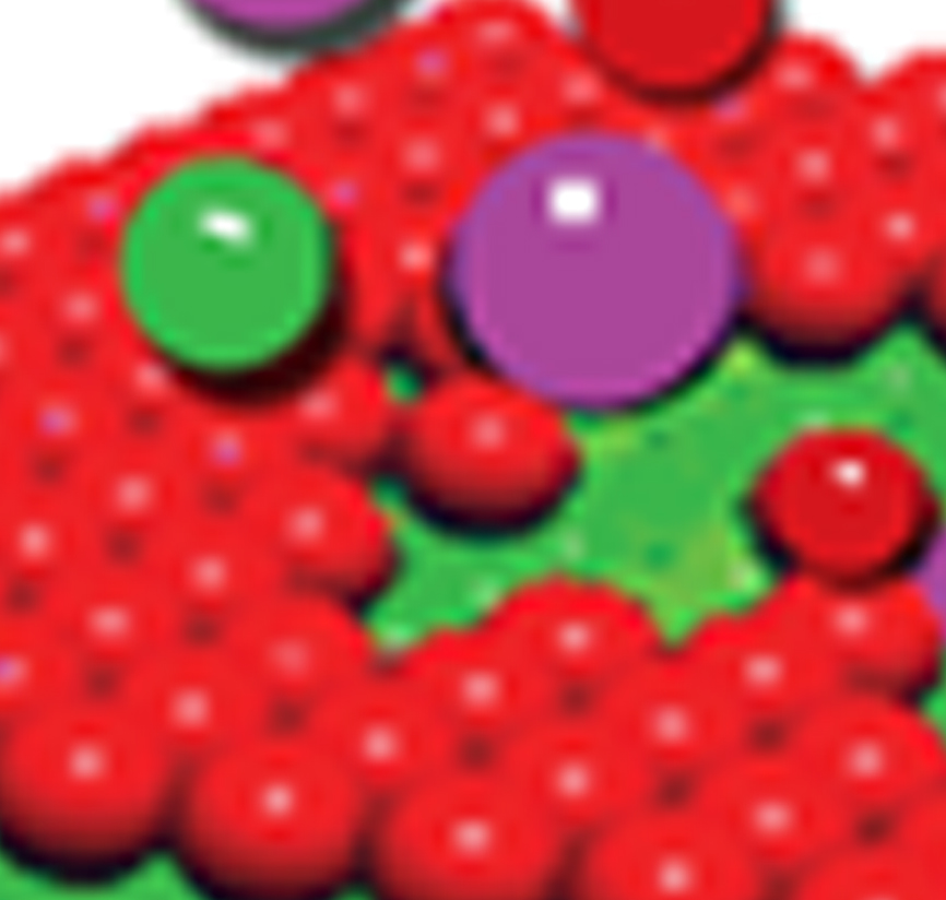

    This is a 1 inch physical size image at 300 dpi enlarged 12 times. This is how it will look to the eye when stood inside 2 meters from the image.
    So this image is now one foot wide
    I agree, over 3-4 meters away you will not see the blurring. But it will still be blurred close up.
    You cant change the way this turns out… it’s just not possible… maybe the image was a larger dpi
    Unless there is some magic formula that I have missed in my 25 years of computer graphics and printing experience…. But if I have then please tell me because I would be on it in a heartbeat!

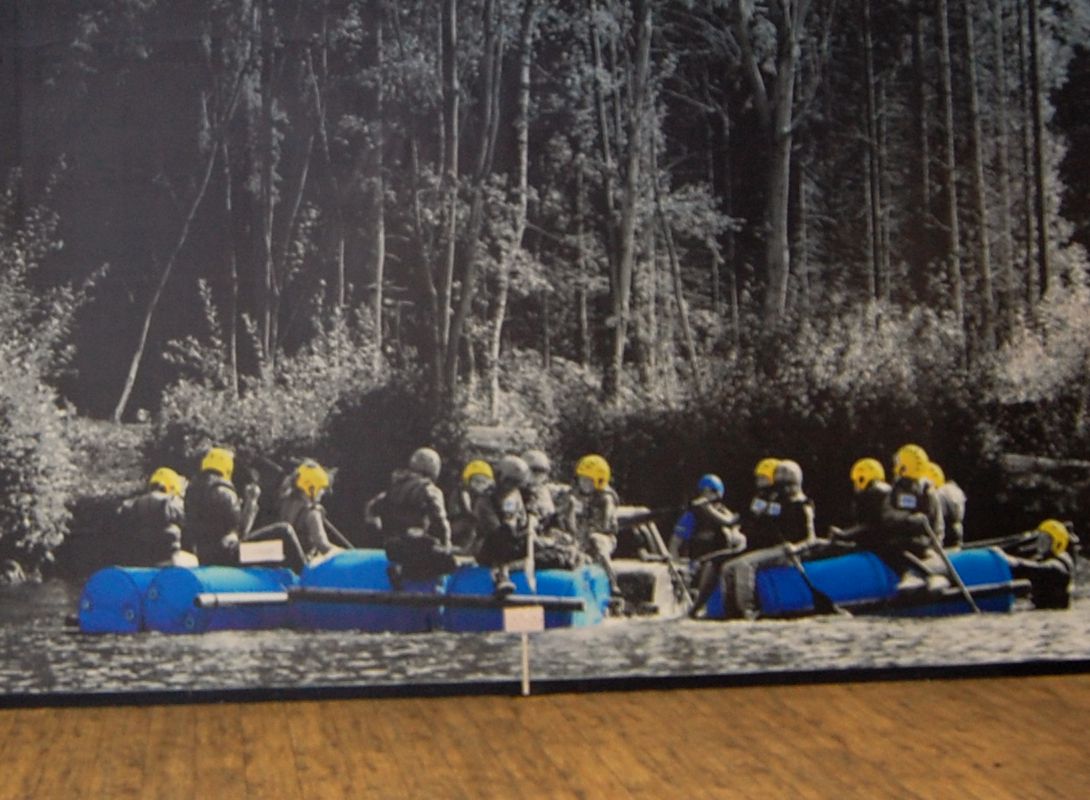

    28 February 2013 at 18:54
    Hi Clive.
    This is the only image I’ve got but cropped so I can bigger.
    The white box at the bottom is an electrical socket so you can compare to the print. It looks great in real life with no blurring 😀

    Don’t want to get into an argument here but after looking at this photo I’m kind of on Mo’s take on it.
    That picture is taken quite away back and it still looks very blurry to me if you were close it would be badly pixelated.
    For a high quality photo print I would try to use 75 -100 dpi actual size so a 10" (25mm) picture at 300dpi will only go to 1m wide at most.
    That picture on the wall looks fine John as it is not a high definition print and the poster style suits what the customer wants, so as you say no problem there.
    its all down to the desired effect/finish required and what you can get away with.
