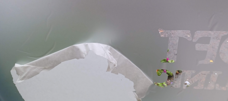

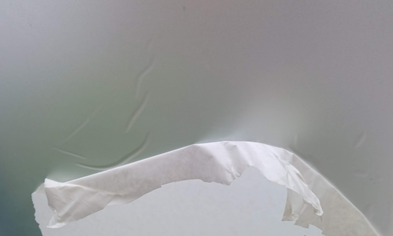

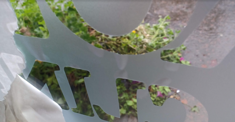

    so today a one hour job turned into nearly three hours!
    i almost gave up several times but i kept at it due to a very sympathetic customer who could see something wasn’t right.
    I fitted the etched vinyl panel with grey text in the middle. the grey vinyl fitted ok, but the etch was horrible. it applied ok, but it didn’t feel like it had a good hold on the glass. and when i tried to remove the application tape, it was impossible. the etched vinyl just kept lifting.
    it was worse around the lettering but even the solid flat areas with no text or graphics were lifting.
    i had to remove the tape at a snails pace but it still lifted.
    the only good thing about it lifting was once i had the tape off, i could lift vinyl back and reapply it.
    the vinyl was image perfect and i have used it multiple times in the past without any problem but today???!! 😫😭
    any advice would be great because i have another to do at the back of the building on Monday and i am not looking forward to it. is it me or has anyone else had problems with it?
    i am now having a large glass of wine! 🍷😃

    Hi karen, this is not uncommon with frosted. I’m assuming you are laying it wet?
    some suggestions are –
    less soap
    Leave for half an hour or longer before removing tape (some guys even return next day)
    soak the outside of the application tape and rub it in with your handle (helps release the glue)
    Depending on where you are and conditions, the glass temperature has a lot to do with it.

    Only thing I would add to the other comments, if applying dry might be a case of condensation/misting on the window. As we break into the colder months windows become more of a pain (pun intended).
    • Karen White
      1 November 2023 at 15:59
      thanks gary
      i fitted it dry and i think your answer is what the problem was. the condensation!
      when i went back, i took a small blow heater with me from my office and sat it back from the window to try and take the chill off the glass and it went on much easier. some parts did lift but went back down with a little teasing and lifting and laying.
      my main problem was the application not separating from the vinyl but with the heater there this was much better.
      thank you so much for everyone’s suggestions.
      thank you everyone ❤
