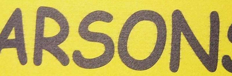

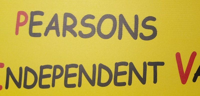

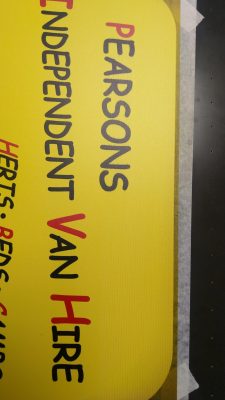

    Check for a ‘hair’ hard to spot but can cause drag issues like this.
    10 April 2021 at 21:34
    I would agree with colin. probably picked up a hair or whatever on the last part of your printing.
    Have a really close look around the head area for a hair hanging or similar, and give it a clean.
  • Neil Davey
    12 April 2021 at 12:39
    Have a look around the edge of the capping station and maybe give it clean, there may be some stray dried ink or hair picking up on the printhead and being dragged across.
