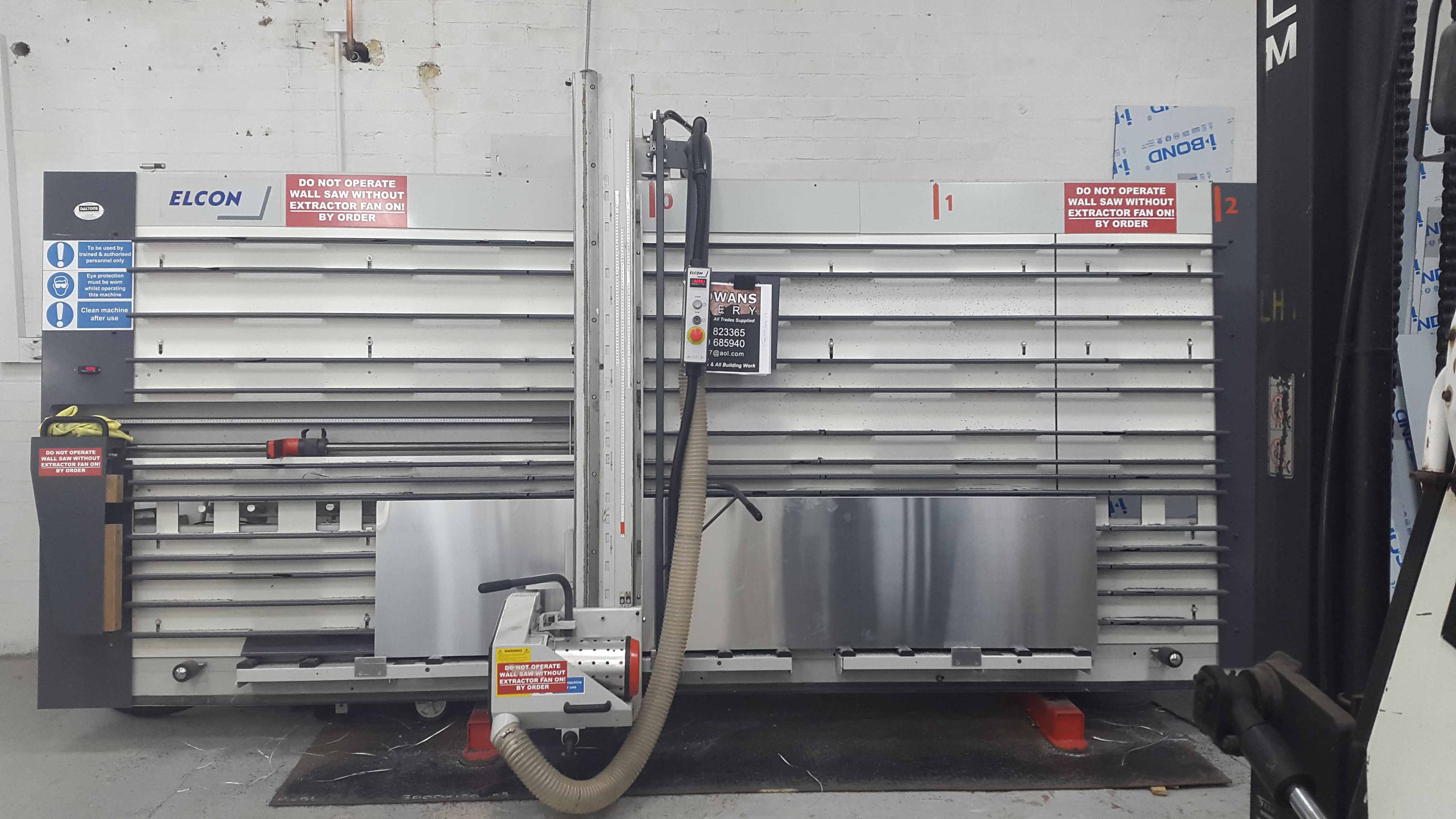

Would love something like that but have neither the space or the funds
quote Adrian Hewson:LOL we use one of these
I use an Altendorf F45 😀 but still finish every panel with a block plane
