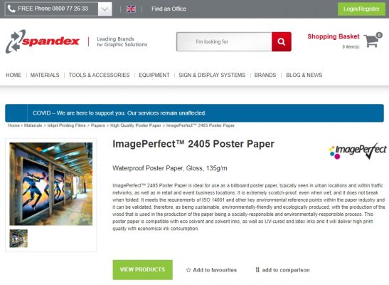

    ImagePerfect™ 2405 – Poster Papier
    I have had good results for years.
    Just changed to some horrible paper available at the time for a rush job. Wasted 15 posters. Didn’t dry properly and all stuck together on the take-up roll, strait in the bin.
