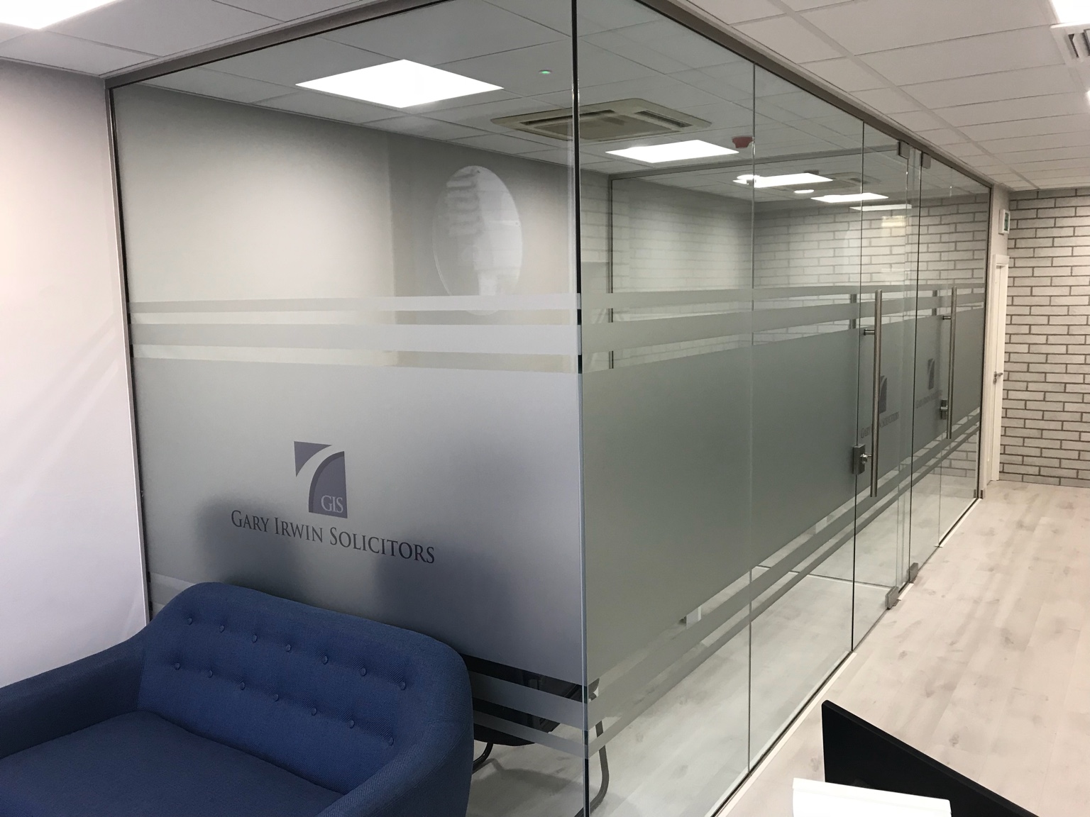

    Office I just did last week. It tones it down. I always print a sample and get it signed off by the client.

    That looks really good andrew. So its a bit of trial and error to get the colours right.

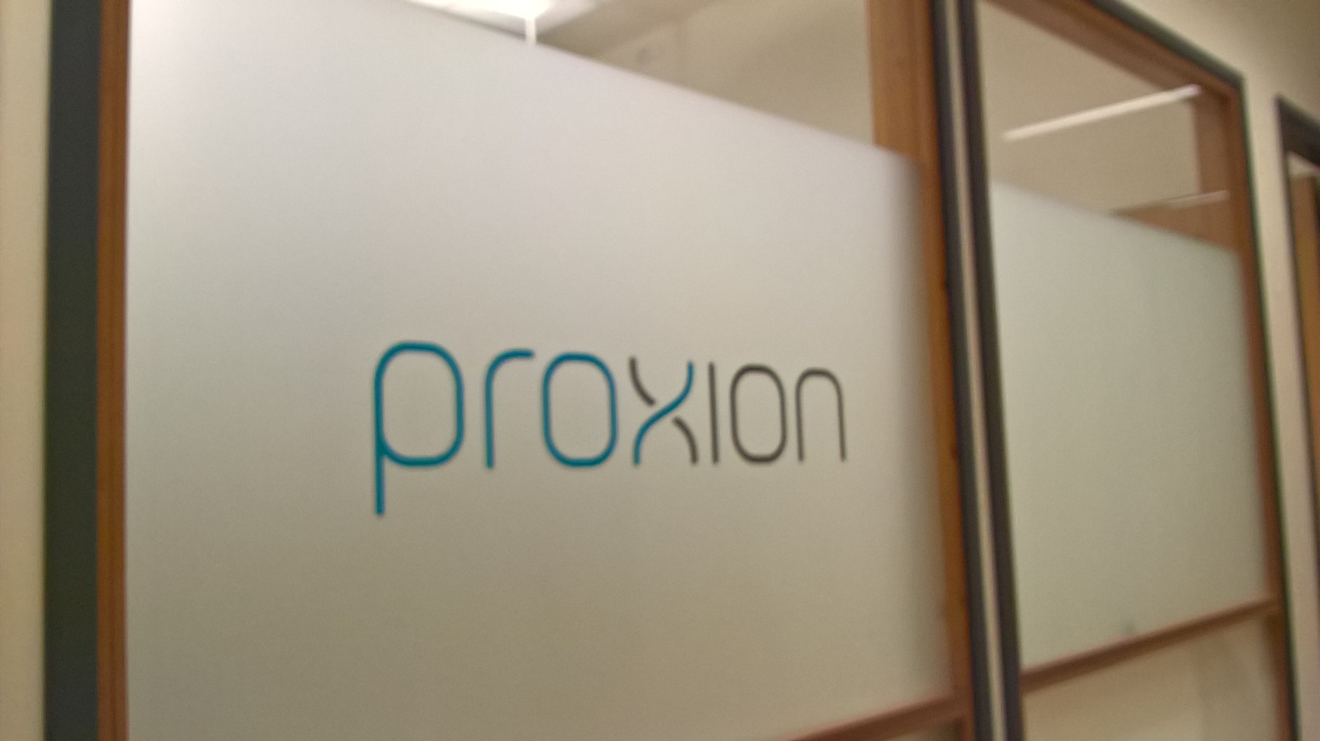

    I did this frosted job last week, exactly wohat the customer requested and it looked good. I just had a feeling it could have looked more interesting if it was printed directly. Also from the inside i dont like the fact you can see the solid colour backing of the text.
