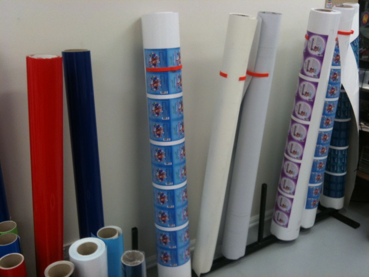

    Put the roll upright vertically off the ground and loosely un wind it. Leave it for 24 hours. To increase the efficiency put a fan ontop of the roll blowing air downwards.
    Pic attached.

    I’d leave it. If you cut it without proper out gassing it will shrink or curl if you have a heavy ink load. If your cutting into un printed vinyl go for it but try to leave the prints un packaged for as long as you can.
    Another disadvantage the prints will be easy to scratch and mark etc if they aren’t fully out gassed and will be hard to apply if your going to apply them straight away.
    So if time allows un wind the roll loosely for as long as you can.
    Vinyl manufactures will advise to out gas for 24 hours usually with solvent inks.
