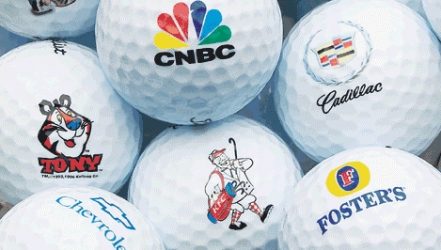

    Hey!
    I recently bought a mimaki ujf 6042 mkii and am printing on golf balls. The print is good but am searching for a method so that the print lasts a bit longer than one round. Do you guys spray the balls with another clear coat? I thought about dipping the balls in a clear coat and leaving them to dry. Any other ideas?

    I’m a golfer, i’m almost certain that ‘dipping’ a golf ball in any sort of lacquer or resin is entirely detrimental to the ball quality and also, I think, against the rules.
    Printed logos usually with stand a decent knock and in my experience the logo usually lasts longer than I can manage to keep the ball itself.

    I bought some golf balls in december, printed directly in Srixon with my logo … factory printed and the logo was great. they print and then do another layer of clear so thats what i am trying to do. when i play, the balls usually last a few holes and the print comes off. I will do some testing so I dont get customers coming back to the shop with “faulty” balls. What do you tell your customers about the durability?

    could it be that you need to prime the surface of the ball “before” printing?
    This may help prevent the ink chipping or flaking when it’s being hit?

    Hi there, I´m using the ujf 6042 mkii too. The Mimaki-primer is universal, but in my opinion not good and not suitable for every material. Try a different primer liquid (by hand) for better durability.
