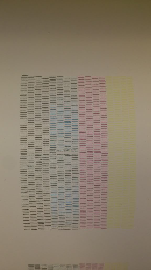

    I have uniform cadet plus 540 machine, I don’t print massive amounts with it maybe every few days as I’m only just starting out.
    Had the machine set up properly by an engineer and was printing great, but now it seems to print everything with a red scale? Could anybody tell me what could be the reason for this? Am i doing something wrong or is the printer doing something it shouldn’t?
    I have done test prints and it seems to be missing a massive amount of the black and cyan, is there a way to resolve this?
    Thanks in advance 🙂

    Your head test is giving the answer – The red scale is due to cyan & black ink not being printed correctly or at all in paces, and causing a false colour shift, simply down to the head need cleaning/fixing.

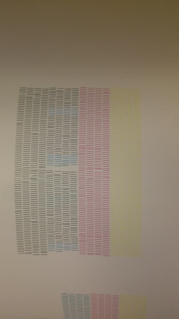

    in the mean time i gave it a good clean and almost got it back to how it should be, but with one exception..
    the cyan was firing 90% black?
    a bit more cleaning and i got it a bit better

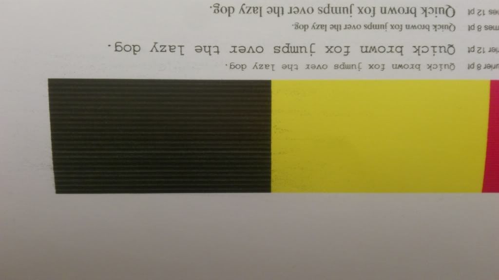

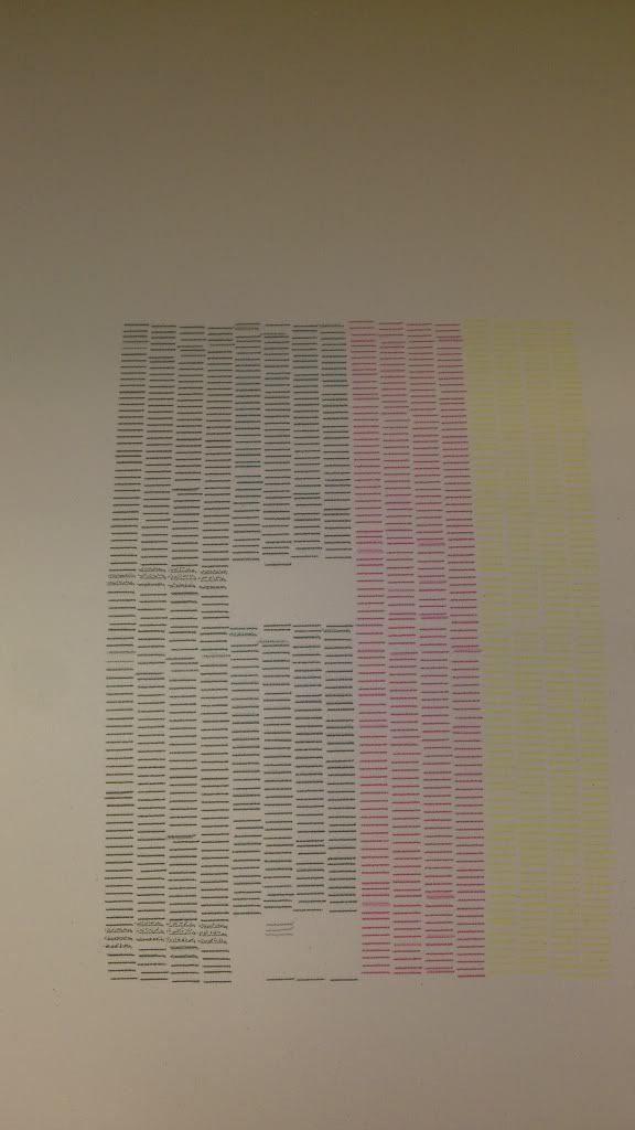

    so thought i would do a test print to see how it would do and thought maybe it just needs the inks to be pumped through a bit, it printed a lot better than the last test print i did (previous post)
    after it finished printing it performed a self clean, so after it had finished i did a test to see if there was any more cyan coming through, and the answer is, non what so ever! came out black and was firing less.
    does anybody know what this would point to? bad pump? cap tops?

    It is probably the pump not working on the black/blue side, black ink has travelled into the blue head if you print a block of pure cyan it should clear but you may have to print quite a bit out, I get this problem when i do a head soak, it can take up to 500mm X printer width block to clear totally but you should see it gradually clearing itself as it prints.
