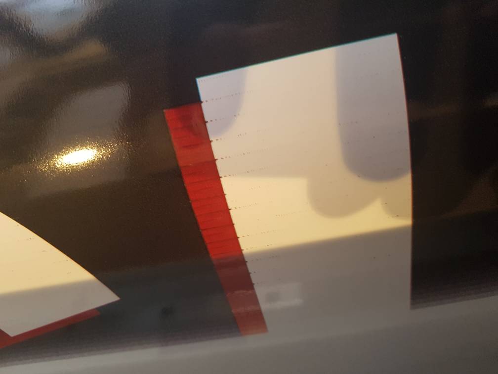

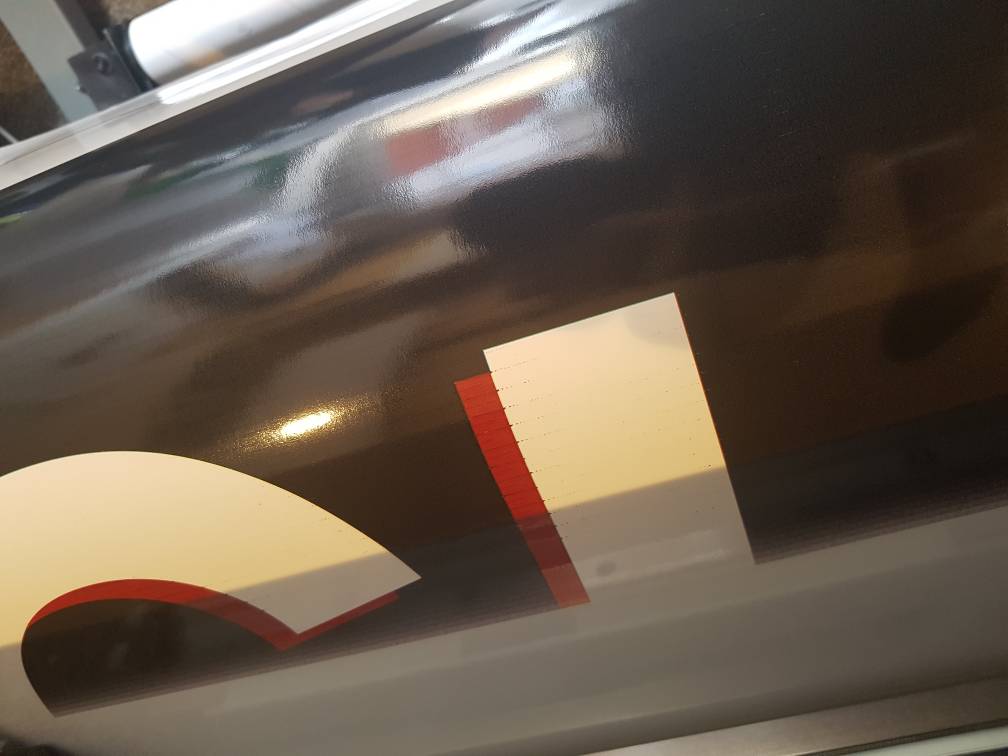

Home › Forums › Printing Discussions › Roland Printers › Printing advice please, Streaks in print? Roland Printers Printing advice please, Streaks in print? Posted by Jonathan feeney on 30 May 2017 at 09:51 Hi guys can anyone tell me why im getting streaks on my print I have attached a pic below ? Thanks Jonathan feeney replied 8 years, 6 months ago 2 Members · 3 Replies 3 Replies Gary Birch Member 30 May 2017 at 14:11 Almost certain that you have something ( hair or fluff) stuck to your head. Not almost the most visible either. Jonathan feeney Member 30 May 2017 at 14:12 Thanks Gary ill have a look Jonathan feeney Member 30 May 2017 at 14:44 Thats what it was gary thanks Log In to Reply Log in to reply. Public All Members My Connections Only Me PublicAll MembersMy ConnectionsOnly Me Public All Members My Connections Only Me Log In to Reply Start of Discussion 0 of 0 replies June 2018 Now
