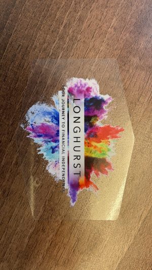

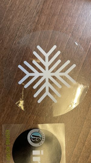

    26 January 2021 at 11:37
    Hi Jamie
    Thanks for the pictures!
    Do you print to optically clear and which brand do you use?
    • Jamie Wood
      26 January 2021 at 11:41
      The snowflake was printed on self cling, and the other 2 on clear self adhesive. For optically clear, we use Metamark MD-CR.
