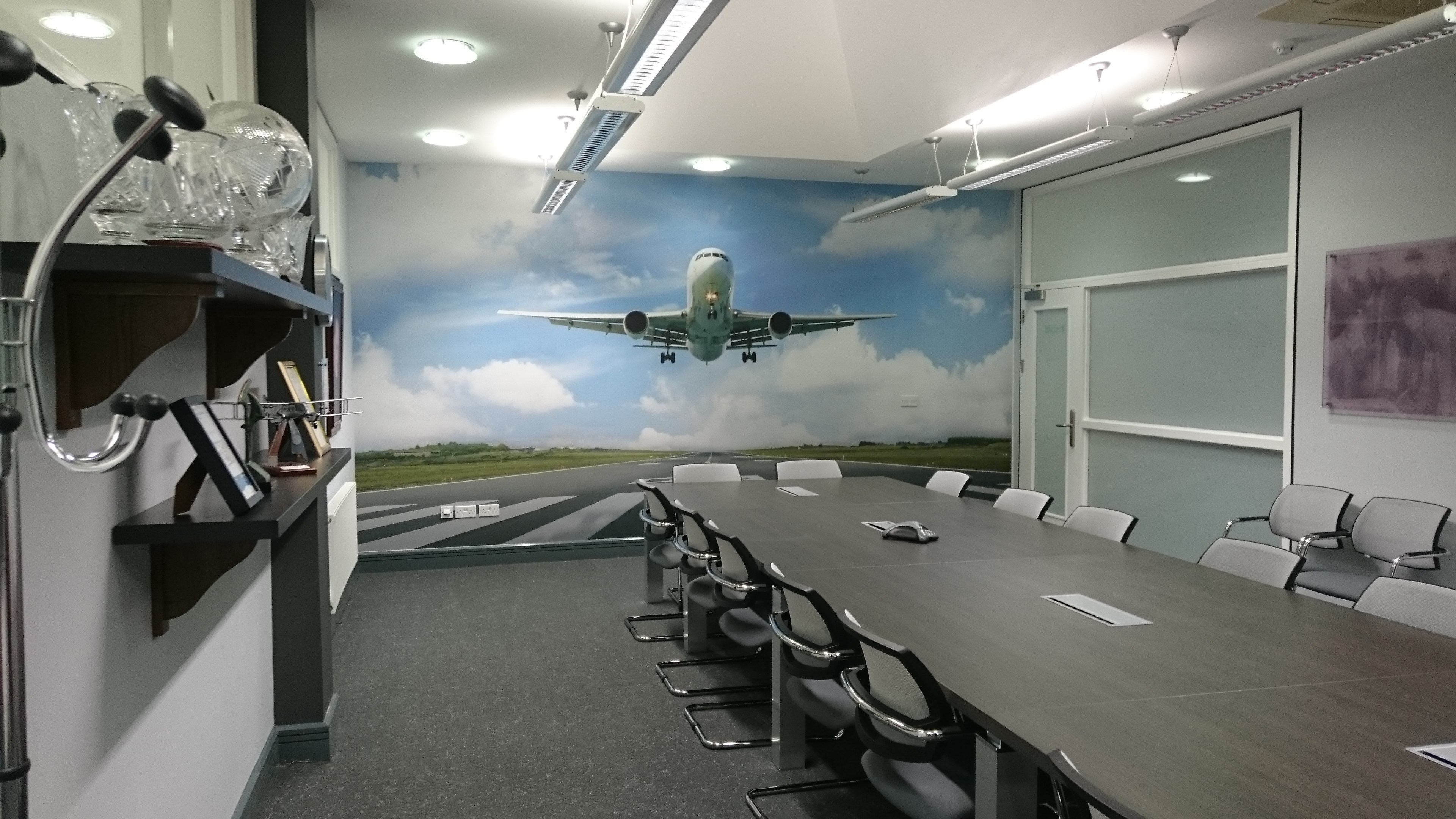

    I’ve just installed my first effort at this & almost identical size.
    I initially got the Metamark WallTex MDTX2 but had some issues with it on my latex printer, although as far as we know according to the manufacturers it was a dud batch. Anyway in the end I used Emblem SOSTBAR Sticky Textile Removable Banner (That’s what they call it but it is a removable textile wallpaper)
    Printed great & fitting was pretty straight forward once lined up carefully as it’s a fairly dimensionally (is that a word?) stable i.e. doesn’t easily stretch. I did make sure that the wall had been primed/sealed before hand with pva as recommended to avoid any potential issues of paint coming away if I tried to re-position it during fitting.
    I did consider butt joining but having heard the occasional story of shrinkage I plumped for overlap of approx 15mm & it worked fine. Although you obviously can see the overlap if you look closely it’s really not an issue & both I & the customer were both very happy with the end result.
    It actually took me on my own approx 5 hours on site but i am not the quickest & was being probably over cautious but wanted to make sure I didn’t feck it up"" 😉 Also If I had had the space at home to lay the prints out side by side to align & mark them up it would have saved me a good bit of time rather than struggling on their boardroom table!! :shake:. But you have to make do with what you have.
    As for charging, that’s up to you how much profit you want to make out of it I guess. I know I frequently seem to undercharge when I realise how much time is involved though!!.
    Good luck with it, hope it works out ok for you.
    Here’s pic of my effort

    Your effort looks brilliant! especially as it was your first go at something like this. Hopefully i’ll manage to get a similar result.
