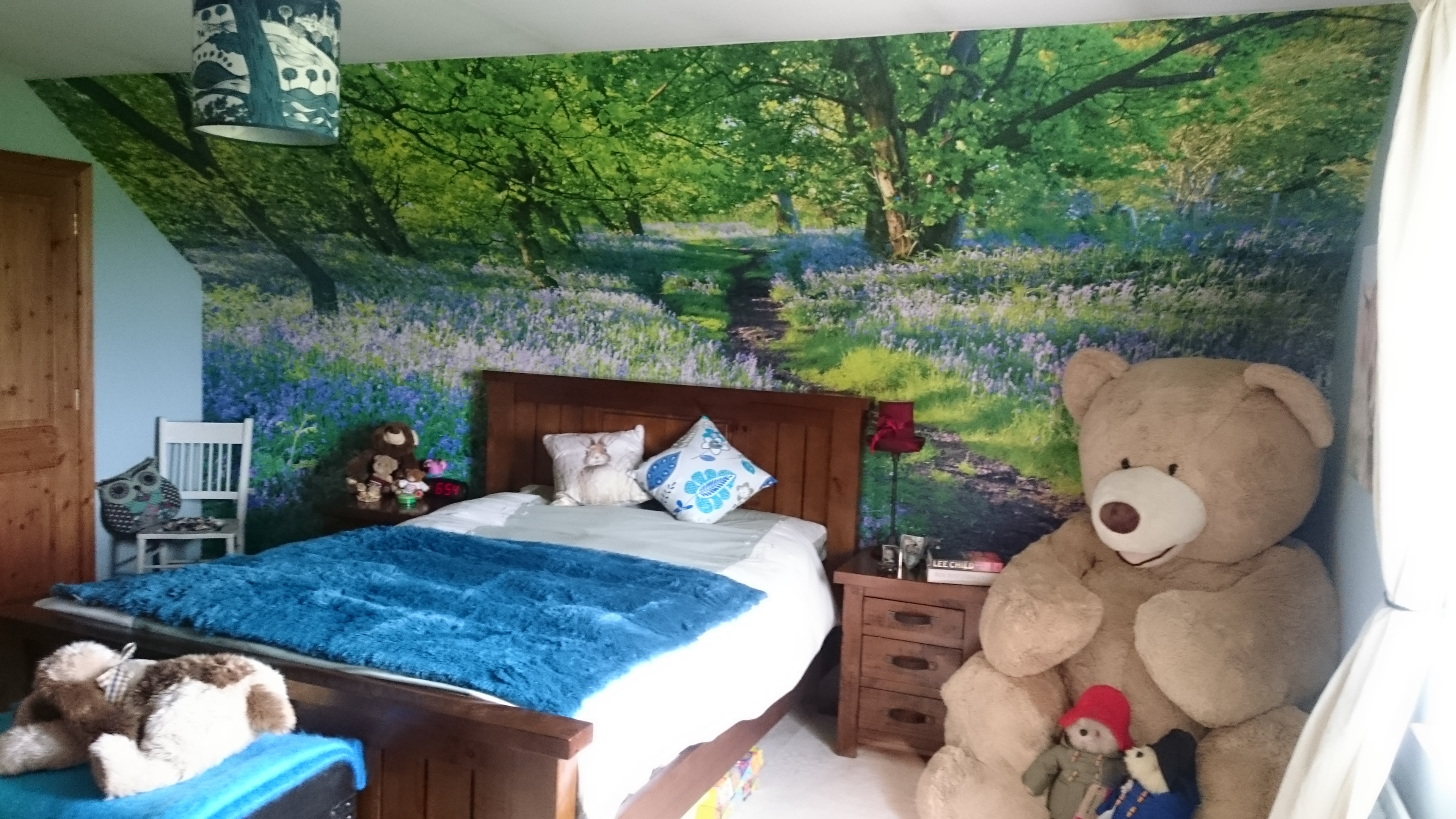

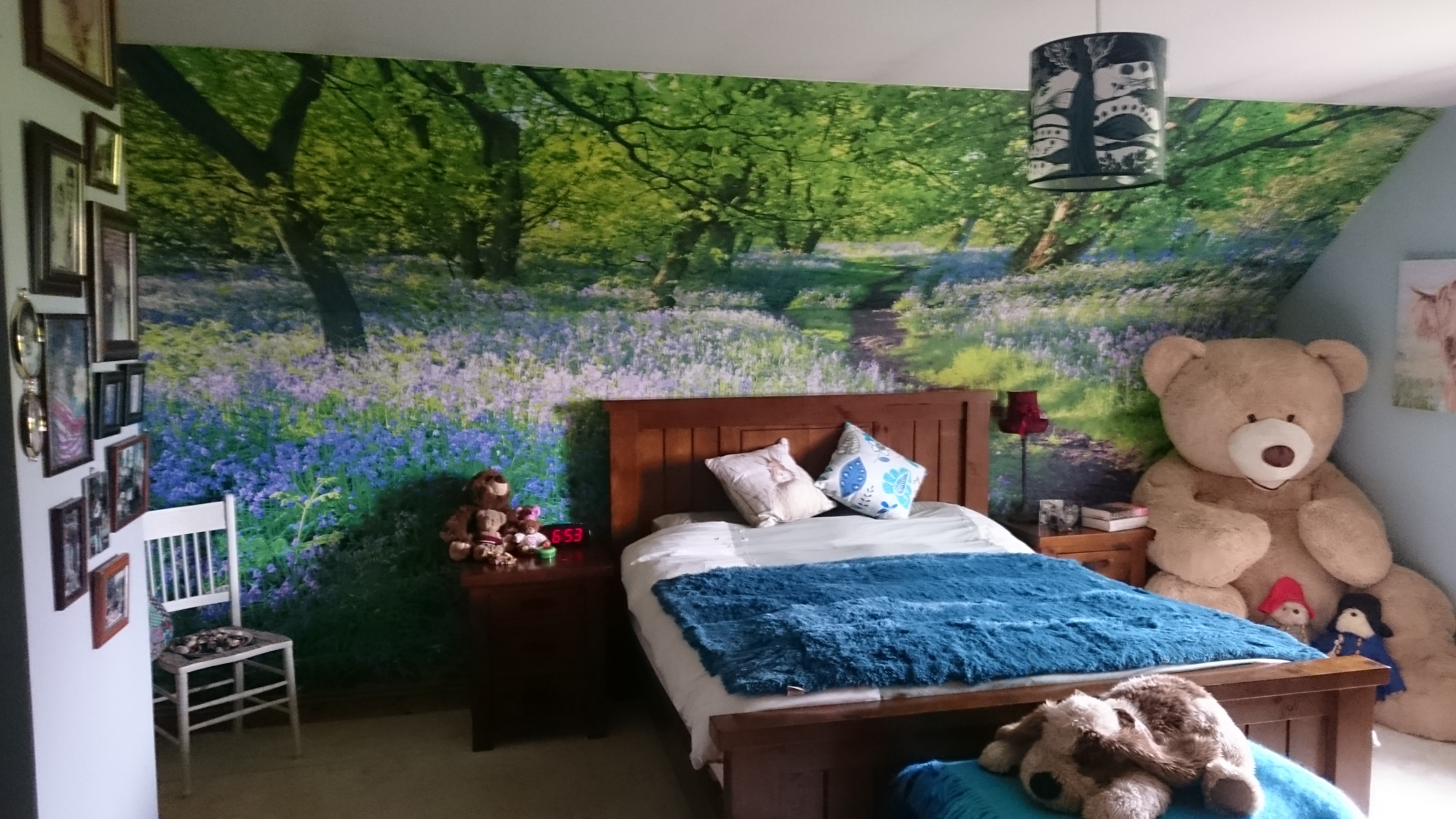

    Only just had this issue myself. Wanted to do a test print & fit on a new wall media (Kernowjet interiors 620) before utilising it on a big commercial job. Wife wanted an image of bluebell woods on the bedroom wall, so I searched istock & a few others but even their biggest images were really a bit on the small size & quite pipelined when blown up. Even their XXL images were only around 12-15mb for 300dpi image at around 30" x 20" kind of size. The wall was 5m x 2.7m. Eventually found one she was happy with just over 40mb & it’s not too bad when you stand a few feet away. It’s not pixely but not crystal clear close up.
    I think for a wall this size you’d really need something around 60mb plus to have a really clear image. Here’s how it looks.
