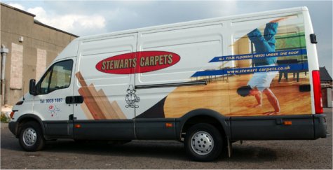

    hey guys, this is one of my first vans using the gerber edge. all those years ago :lol1:

    nice work, how did you manage to get the print to conform the recesses? and still manage to match the tiles?

    With using the Gerber Edge, u could only print 1′ width at a time. Which worked out quite well. We put the panels on one at a time, rubbing them down as you would with a flat panel. Then using a heat gun slowly conformed the print to the recesses. You then take the next panel & match it up then repeat the process. Once all the panels were on, we cut the curve using a knife.
    There was 12 hours work involved. It worked out very well.
