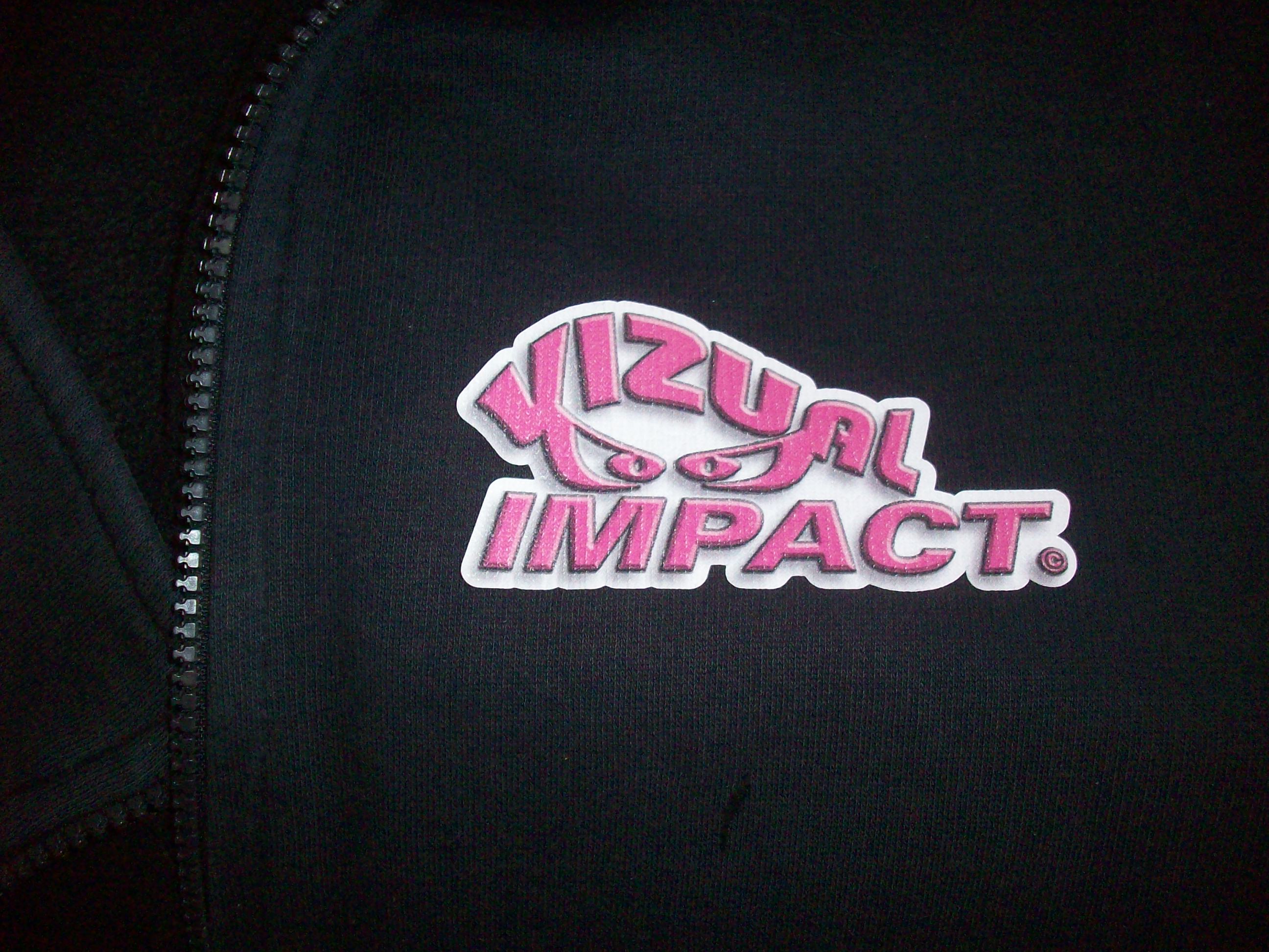

Thanks Martin, good to see that but would be interested in a higher quality finish I think. I was told that direct to garment printing will outlast the shirt but could just be sales talk so hope to get some additional feedback.
Thanks for taking the time to reply.
Warren
