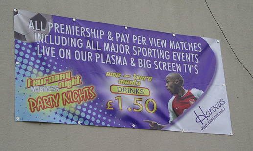

    A while ago l asked the question about joining banners with tape.
    I had a bloke in who wanted a 10 x 5ft banner the next day, normally l send away but it wasn’t an option because of the time.
    I had some tape in from grafityp so l tiled it on the versacamm, lined it up after printing and taped it together.
    Fitted it the next day and wondered if it would last the distance. Well this is the banner two months on, still together on a windy seafront in Skeggy!!!

    looks great.
    what protection did you use, if any?… ( no sarcy comments please)
    30 November 2004 at 23:51
    looks great mate, how much are you talking about for a roll of this tape?
    how mant metres on a roll?
    becky, for banners you dont need protection, just print it. im sure billy is using a versacamm so UV stability is high & on a banner abrasion, washing with chemicals etc isnt really and issue for eco-solvent or solvent inks as they are normally fitted and forgot, not washed regular etc
  • Pryam Carter
    1 December 2004 at 08:49
    Robs correct, no protection on the banner.
    As for the roll it was 50m ( i think, could have been 30m) and was only about £6.00. Bargain.
