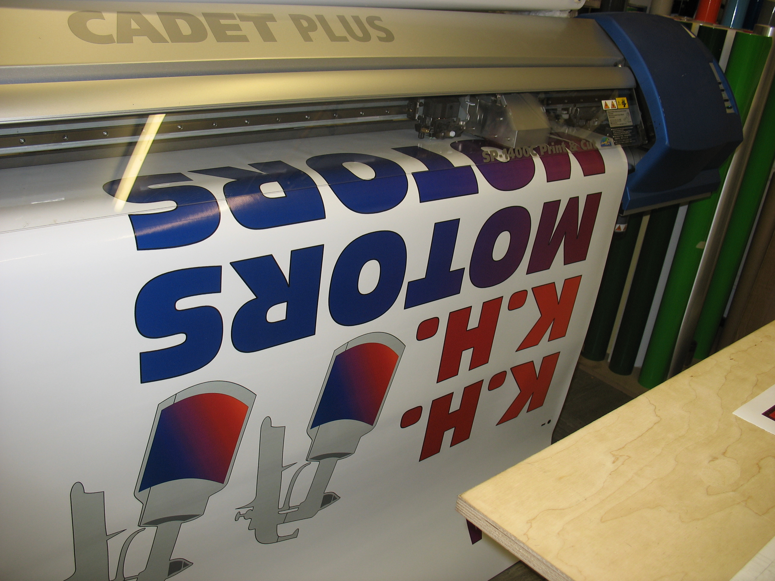

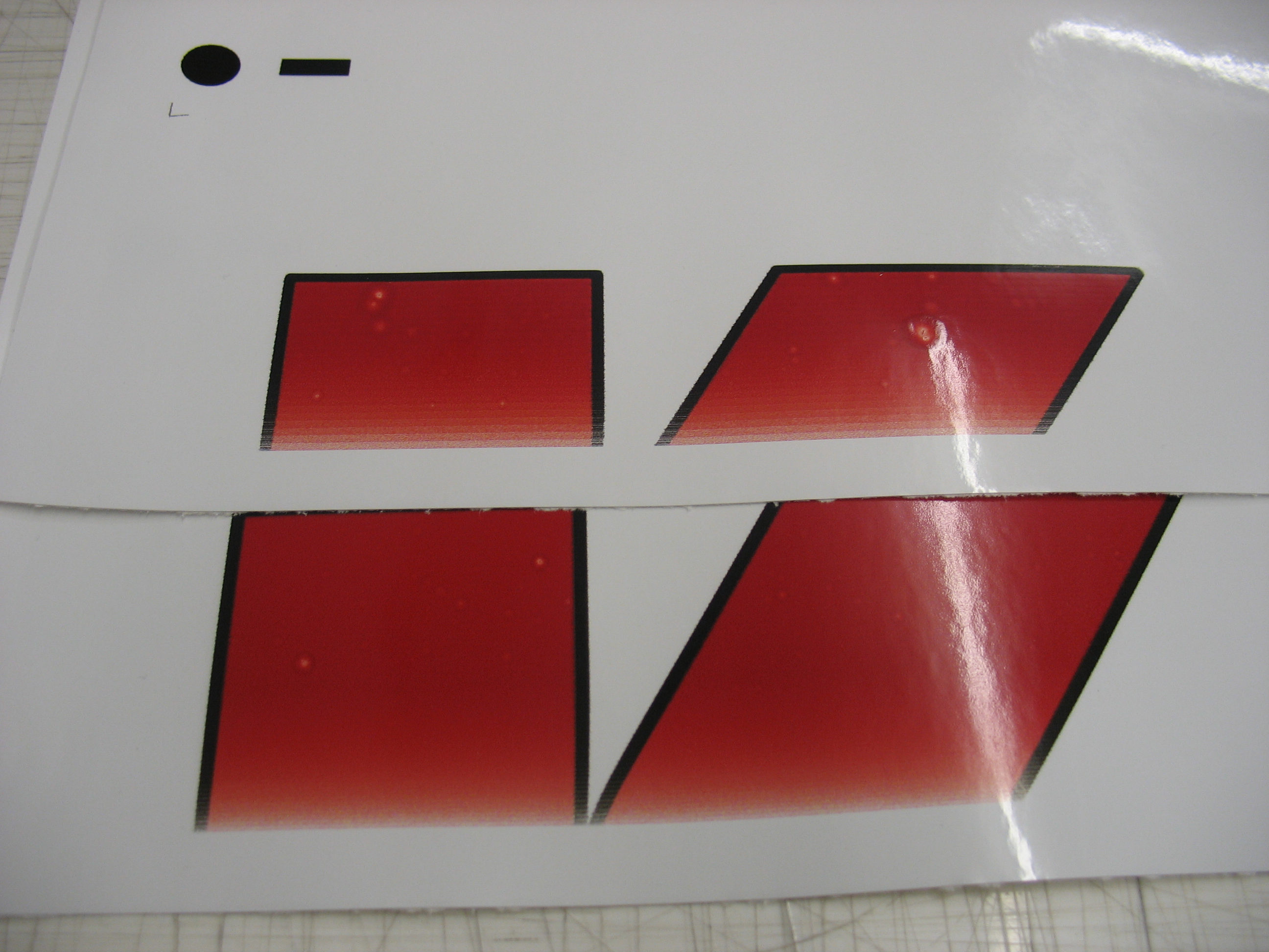

    hi all trying to print this and cant seem to find whats wrong
    looks to be printing ok and then the dots appear
    vinyl is clean etc
    seems to be in the red any pointers
    derek

    HI DEREK
    had this problem when i first bought my grenidier – it came down from the warehouse with really fine overspray of grease/oil from the manufacture
    had to have engineer down to give it a right going over
    maybe you might have got some of the same thing from something you sprayed near by maybe???
    or maybe worth a powerful clean on the heads??
    Col

    thanks colin
    its doing me head in everthing is squeeky clean
    i think there is just too much ink going down
    and starting to seperate i think 🙄

    yep good spring clean around in and on the printer. try another make of vinyl as-well just to check. any body sneezed near it.
    ps you might have defections on the black head as well not this problem.

    hi again after a fair bit of trial and error i have went back to the cadet plus set up rather than the sp540v
    and it is printing as it was no problem the the colours are not as vibrant but not flooding the sheet as they were
    i know it looked pretty bad as if it was a machine problem but i think it was a set up problem. as its running fine (fingers etc crossed)

    Hi derek i get this from time to time on my rockhopper usually a good clean media and heads does the trick if not profiles seem to be the problem to much ink putting down hope this helps???
