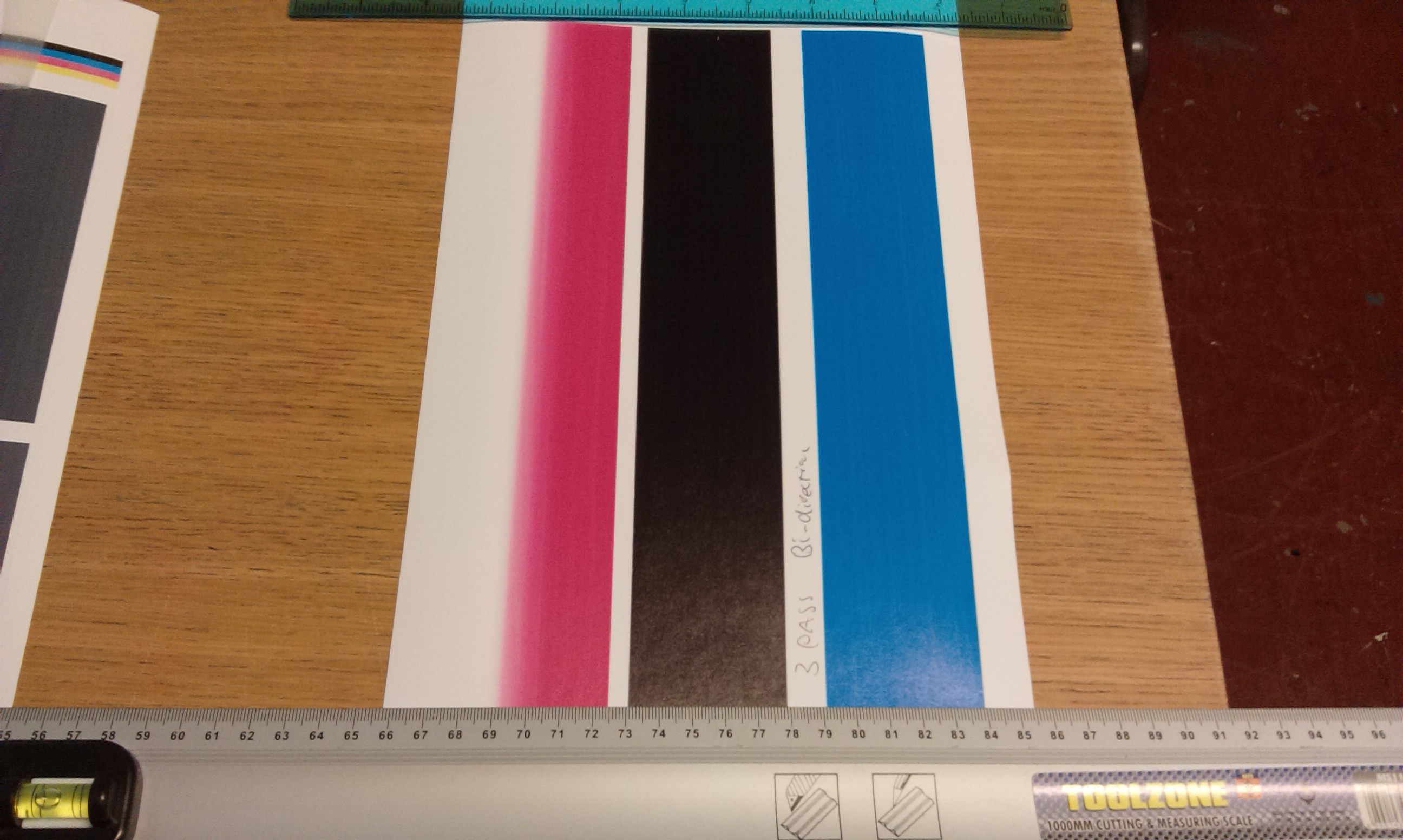

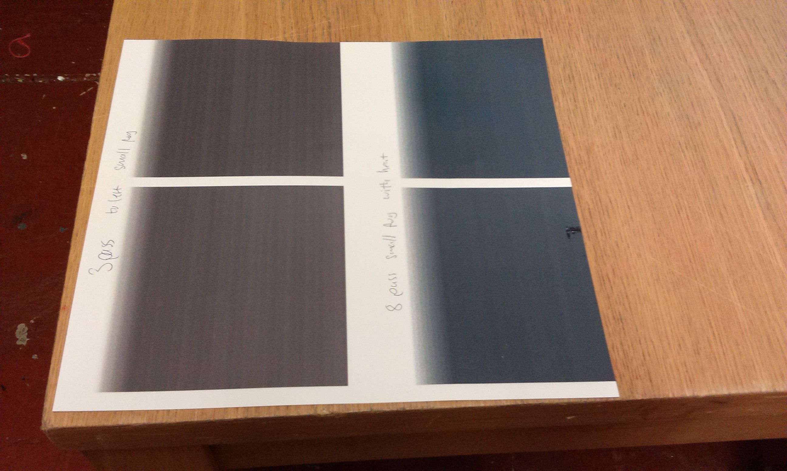

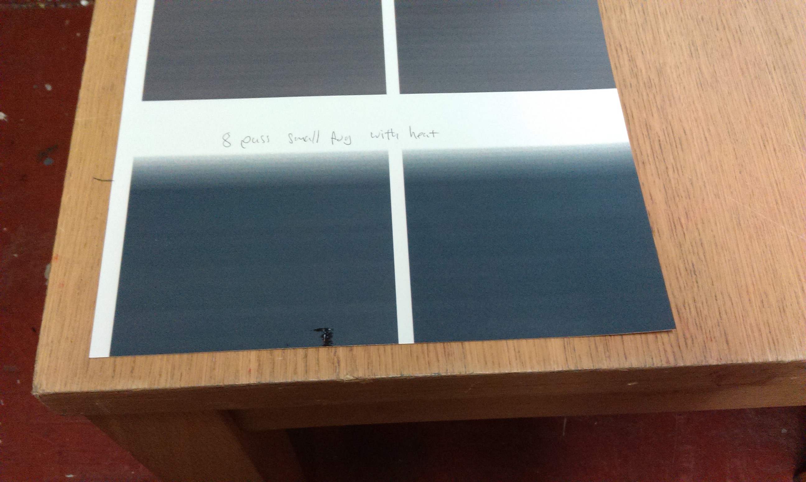

    We recently bought a Galaxy Printek Eco-Solvent printer 1.6m. We have found the printing is ok on 3 pass / 4pass on vinyl, it is very good with 8 pass, however when printing onto poster printer the print isnt good, with very visable banding, and if printing on 3 pass it is terrible, especially with certain colour like grey and with solid blocks oof colour. There seems to be two types of banding, a consistent thin lines, up close they look like magenta, and then the other banding is very inconsistent, creating a dark streak, next to a patchy streak, have a look at the attached pics.

    This sounds like a profile issue………..it will need to lay down more ink on poster paper as this is more absorbent that vinyl.
    Chinese machines typically only have a "one fits all" profile.
