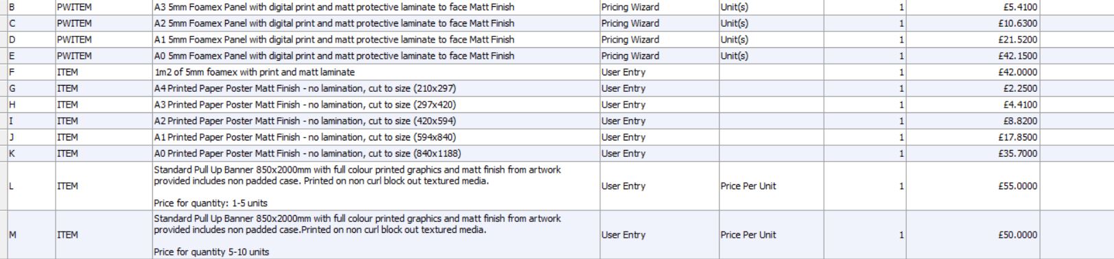

    One from today for a new client – price includes install on panels provided

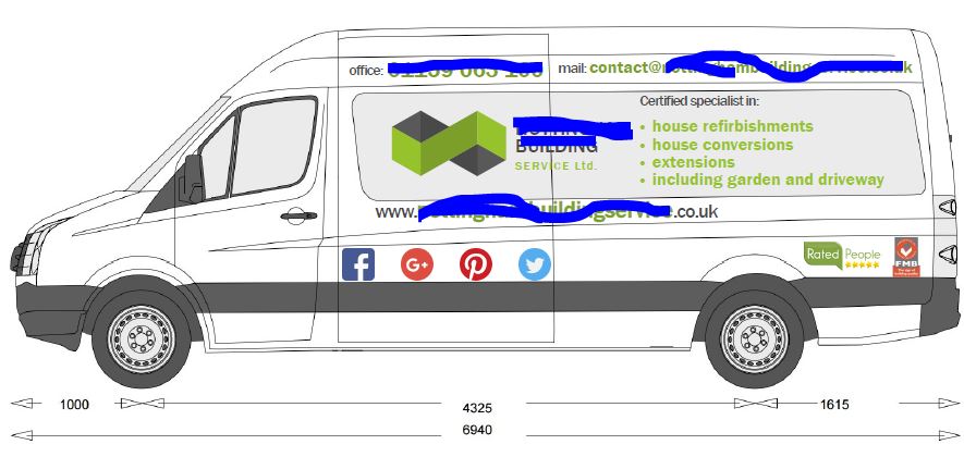

    22 March 2017 at 20:14
    Van quote from today

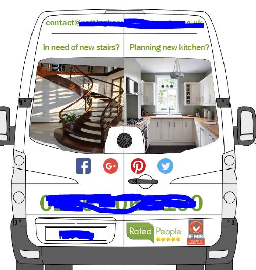

    22 March 2017 at 20:17
    Back of the van

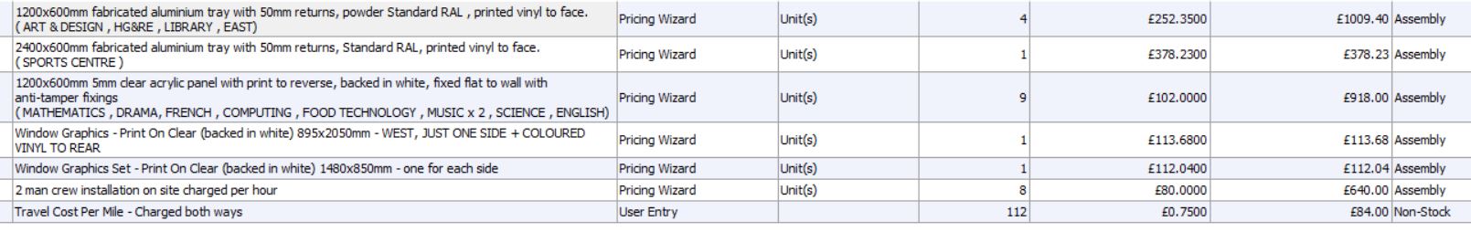

    Foamex Panel for industrial unit – supply only simple layout included

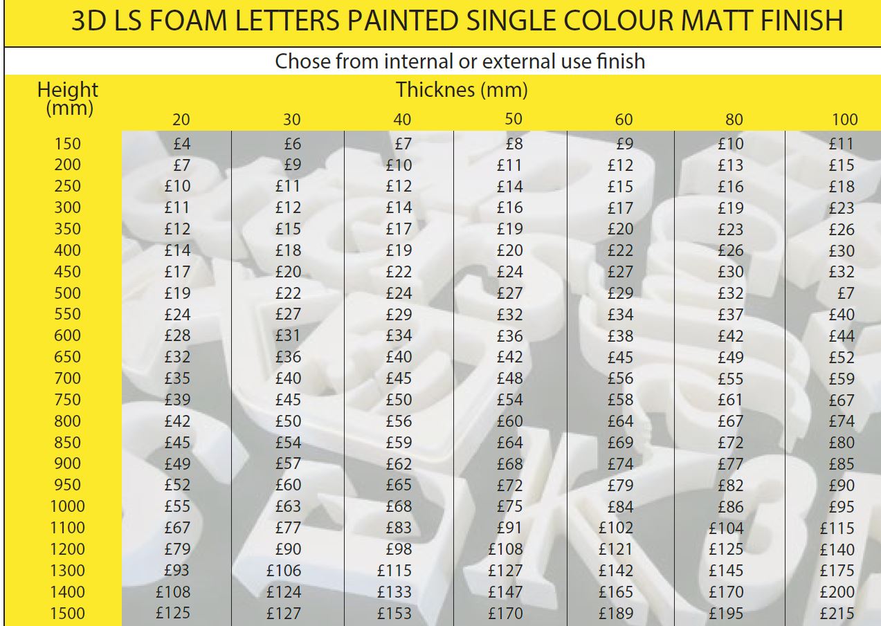

    This is a part of price list of our extruded foam built up letters
  • Martin Lemiesz

    quote Martin Lemiesz:
    B&D seem quite low – certainly think you can add 30% to these prices wheras A&C seem abnormally high in comparison
    23 March 2017 at 09:04
    Seems quite low – I did something very similar back in 2011 and charged £600 + VAT which even then seemed cheap at the timwe
    Seems about right – a good price

    I do think you have scope to increase your prices – maybe not across the board entirely, but certainly in most cases.

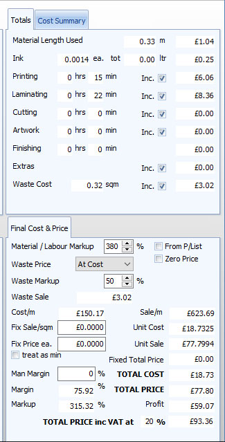

    I’ve left the laptop at home, but I’ll take a screen grab of how we price a van now in clarity.
    23 March 2017 at 16:48
    Here’s a screen shot of the assembly wizard we recently set up for van signs.
    I’ve manually overridden the price on the vinyl to £45.00 SQ/M, enter each printed part (this one is two logo’s on side, and a rear window on a car) enter the number of meters of vinyl to do the job, 3 hours to fit. Design was literally 10mins as it’s same design onto a new car.
    We do the same for signs where it’s built with multiple components. If it’s just a flat panel we’ll just run it through the calc wizard.
    I’m getting your 2900x700mm foamex board @ £208.93 +VAT.
    The A3 Foamex print, clarity is throwing a wobbly and recons it will cost £18 to produce, that’s not charging for waste as I’d probably use an off cut (that’s probably already being paid for anyway!). Assuming it’s a single job. There’s 15mins to load the printer, load the file, RIP the file, Printer does it’s clean, and the print it. 20mins laminating, includes the laminate, time to laminate the print, then mount it to the board. Ignoring the price clarity is saying, and it’d probably be a minimum of £25 for a one off.
