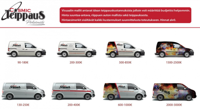

    Hi leslie. Its simply experience! The more vans you do the better idea you have of what certain designs can costs. We all know our ballpark figures, that simple designs and info for example can be 150 to 300 quid. Larger vans with prints etc can be 500 to 1000.
    Also i recommend if not to show customers but for yourself, a simple pricing structure of what you can expect for difference price ranges. As an example here is mine from my website.
    Get a feeling of where they want to be, then they understand what they can afford and the designing can start.

    Martin has posted a brilliant starting point for discussion of range.

    Martyn, your example is very close to how I do it, mate.
