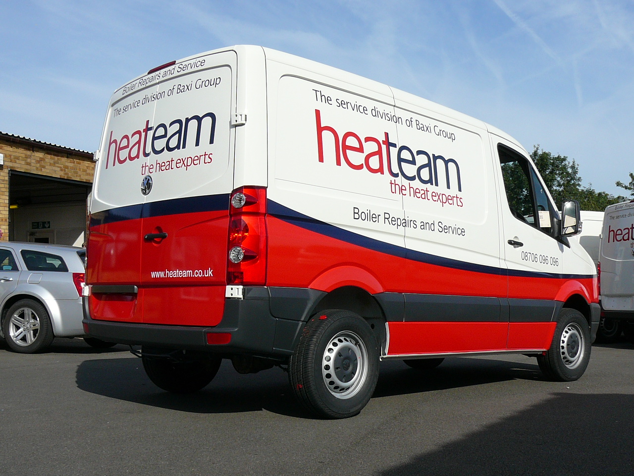

    Depends what we’re doing of course, but this is Avery 900.

  • Peter Dee
    2 May 2008 at 11:16
    John, on seeing that van and your earlier replies, would you just apply a long sheet of vinyl to the side and then work it down as for wrapping?
    Does the cast vinyl snatch back off OK without tearing for re-positioning?
  • John Childs
    2 May 2008 at 11:46
    quote Peter Dee:
    Peter,
    For that particular client, we have to be able to supply individual sections that can be fitted with the skill levels found in the average bodyshop, for accident damage repair. Therefore we have each piece individually digitised
    However, on a one off job we would go with one long sheet because it would be quicker and easier.
    Avery 900 snatches back fine. As mentioned above the initial tack isn’t too high. As with everything though, practice and familiarity helps.
