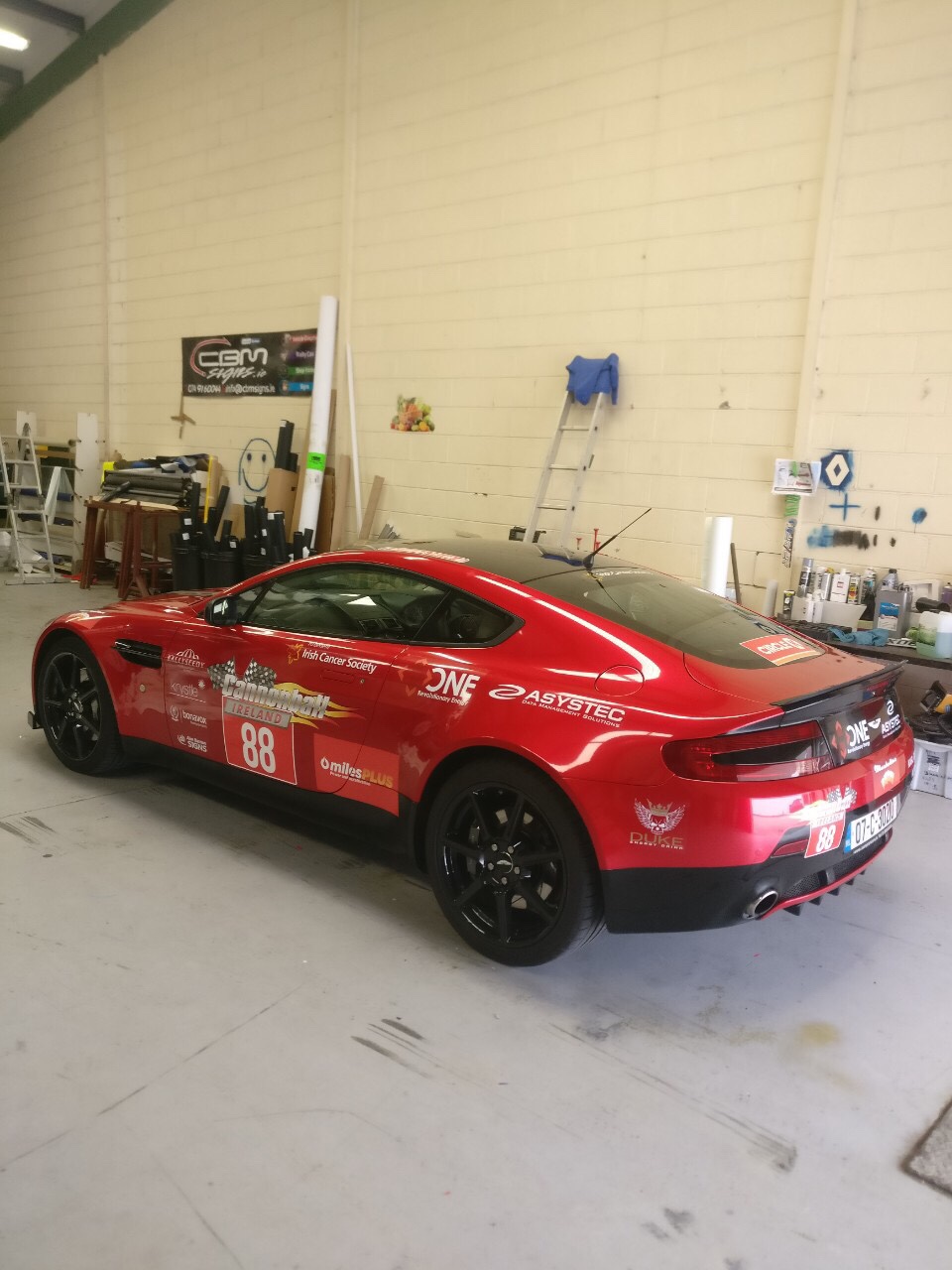

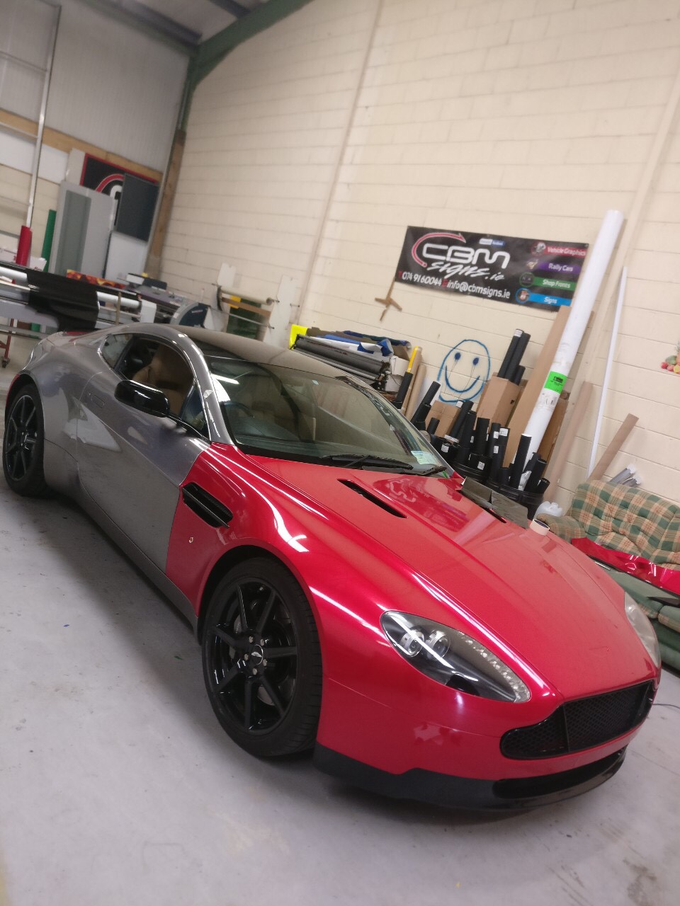

    That’s great feedback David. Just finished this wrap today. I presumed the PPF stuff was free hand off the roll [emoji85] templates are interesting.
    What are you guys using recommending to protect the wraps?? I seen a car detailer using ceramic polish but don’t know how that would work when you go to remove the wrap later.
