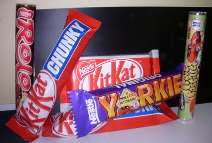

    The inside of the bar is EPS cut using a CNC hot wire machine. We had to buy the real bars, measure them all round and consume them, then scale them 9 times. We have probably been scaled up a little too, especially around the waste .
    The wrapper was done by print and laminating and stuck on the edges as per the real bars.
    The rolo, fruit pastille and aero bars had foil on the ends……….just like the real thing.
    It was a good project to work as everybody is familiar with the real thing and it was good to see them super-sized. The client was very happy too.

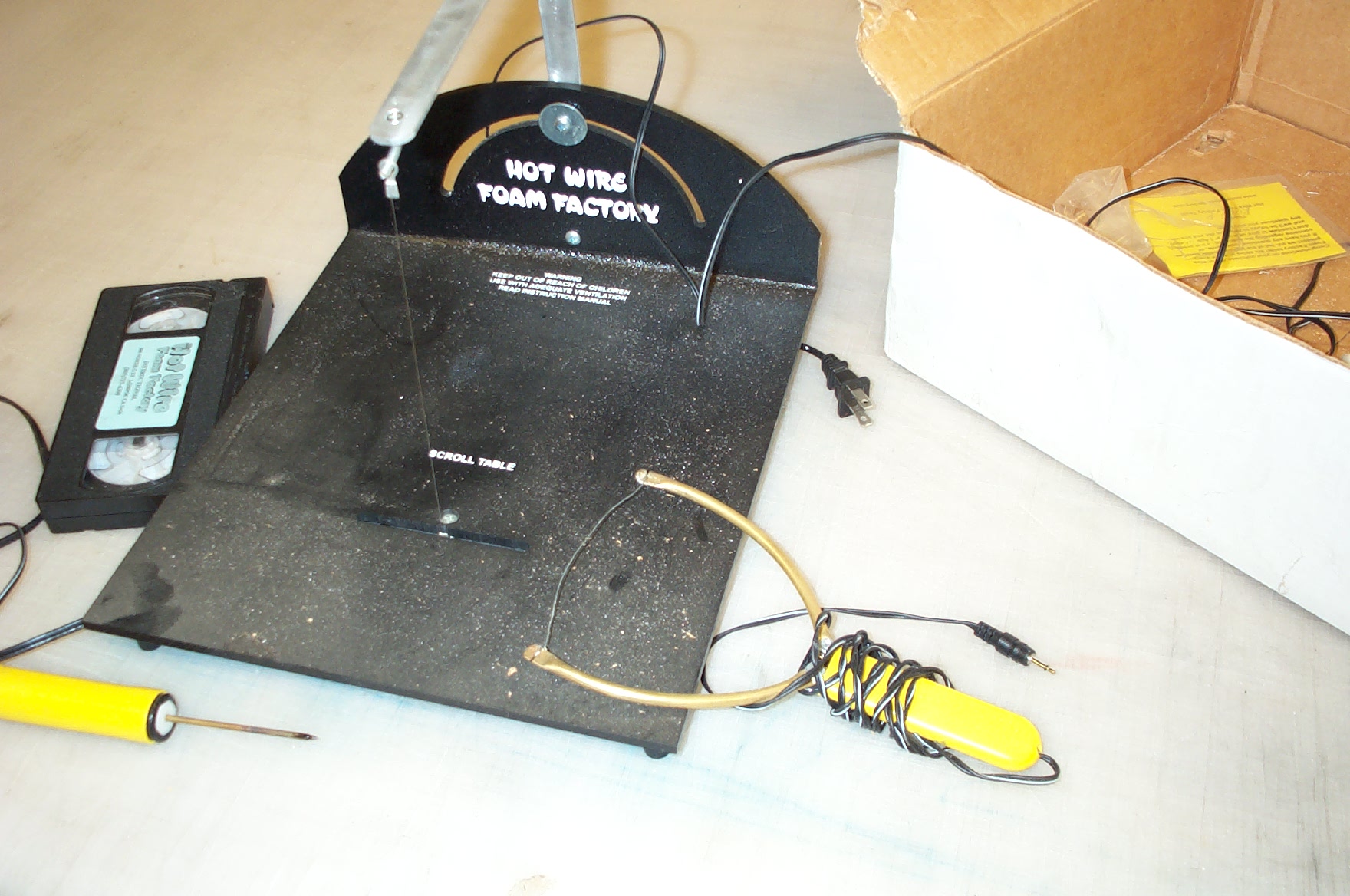

    so are you limited to squares with this CNC? how many axis.. sorry never seen a hot wire CNC before… sounds very interesting.
    20 January 2006 at 20:54
    Dave me ol mate, there was a couple being demoed at sign uk last year,
    basicly 2 wires at right angles, so in effect 4 axis
    Its quite simple to make a hot wire cutter for freehand use, very effective for polystyrene, Many automotive proyotype and design models are made like this

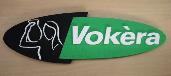

    we are not restricted to squares or simple shapes. It is quite a versatile machine but tend to use it as a 2 axis cutter. What we like most is the variation, last week we created curved walls for a tiling company for a walk-in shower area and then we were cutting valentine hearts and then a cone shape 4m high for an event management company.
    Attached are a few signage examples to give you an idea of what we can create.

    The hot wire cutter described has a fault though, when the wire gets hot, it will expand, making it slack, so you need to incorporate a tensioning system

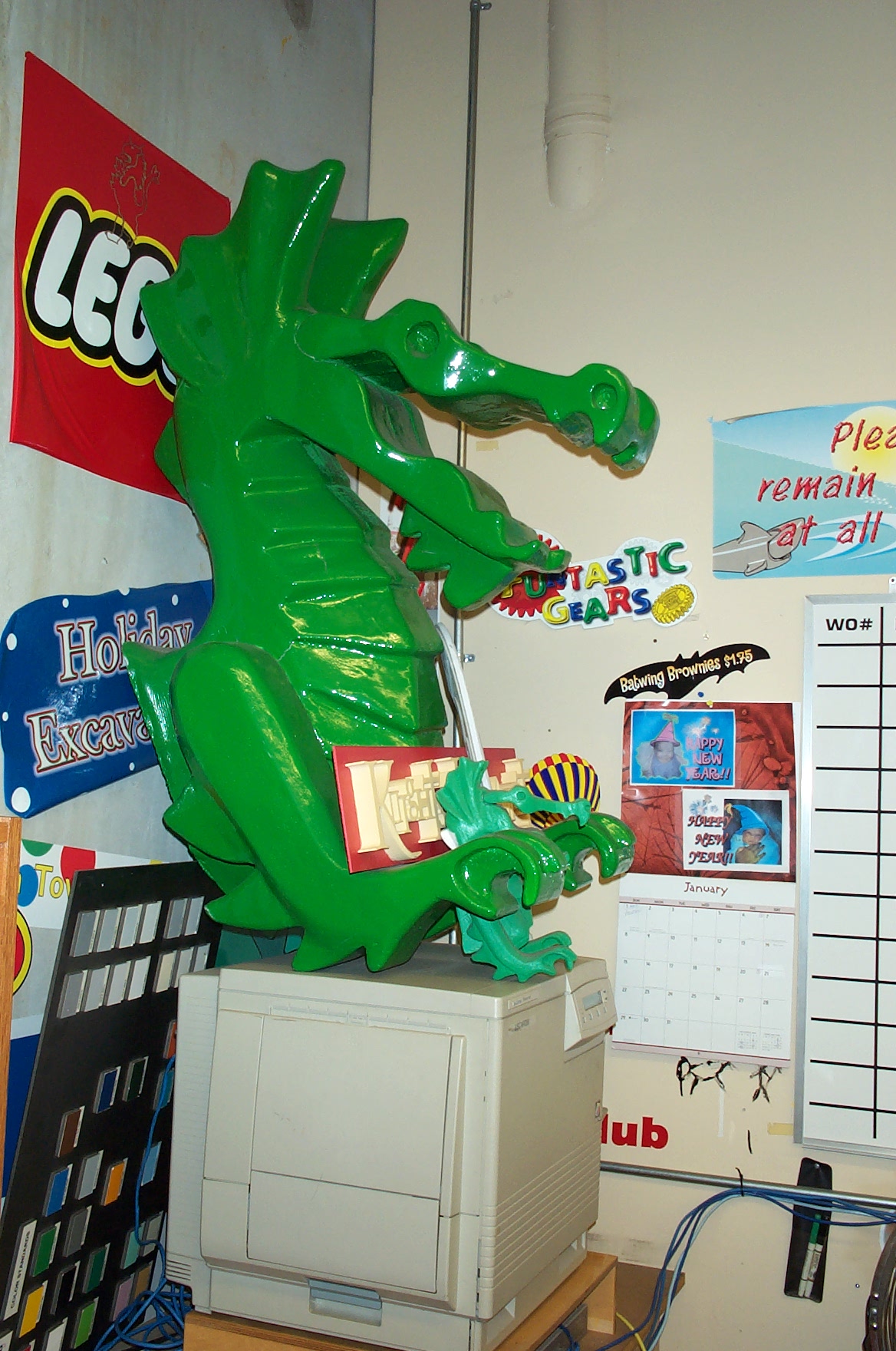

    We have a hotwire at work although I have never used it. One of our previous employees made this dragon using it though.
    -Marek
    21 January 2006 at 21:57
    2 questions Marek,
    do you know how the gloss finish was achieved on the dragon?
    is that a panasonic laser he is sat on?
