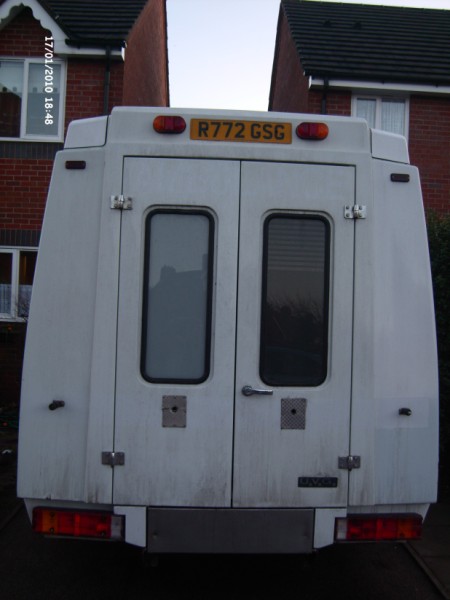

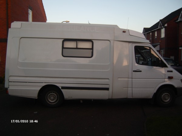

    i have this wrap to do and have found it very difficult to do the actual install as i mainly do printing. I had a go just to mess it up. Now that i have it i was wondering if it would be possible to wet applicate as i Am only doing a partial wrap on a sprinter. the back and half the sides. obviously i respect this should be done as dry but can i get away with a wet application as i wont be doing any bumpers. i have attached pics.

    Don’t do it wet if it takes in the recess on the sides. It will not stick, will hold water, and will pop out.
    If it is just the flat surfaces, wet application will work, however if you used ez apply, you could still do it dry reasonably easy.

    Dry is the only way to go with recesses, in what way did you mess up Phillip?
    and what materials are you using?

  • Jason Xuereb
    12 April 2010 at 14:45
    Thats a fairly deep recess theres a recess in a recess.
