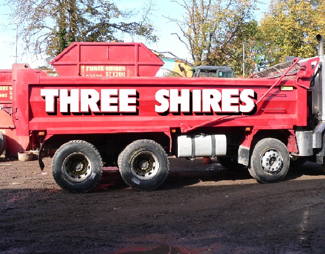

these are a a fair bit longer than 3m. (sorry only mock ups) but we have done these in reality, laid up on the bench, and on the vehicle, always dry.
