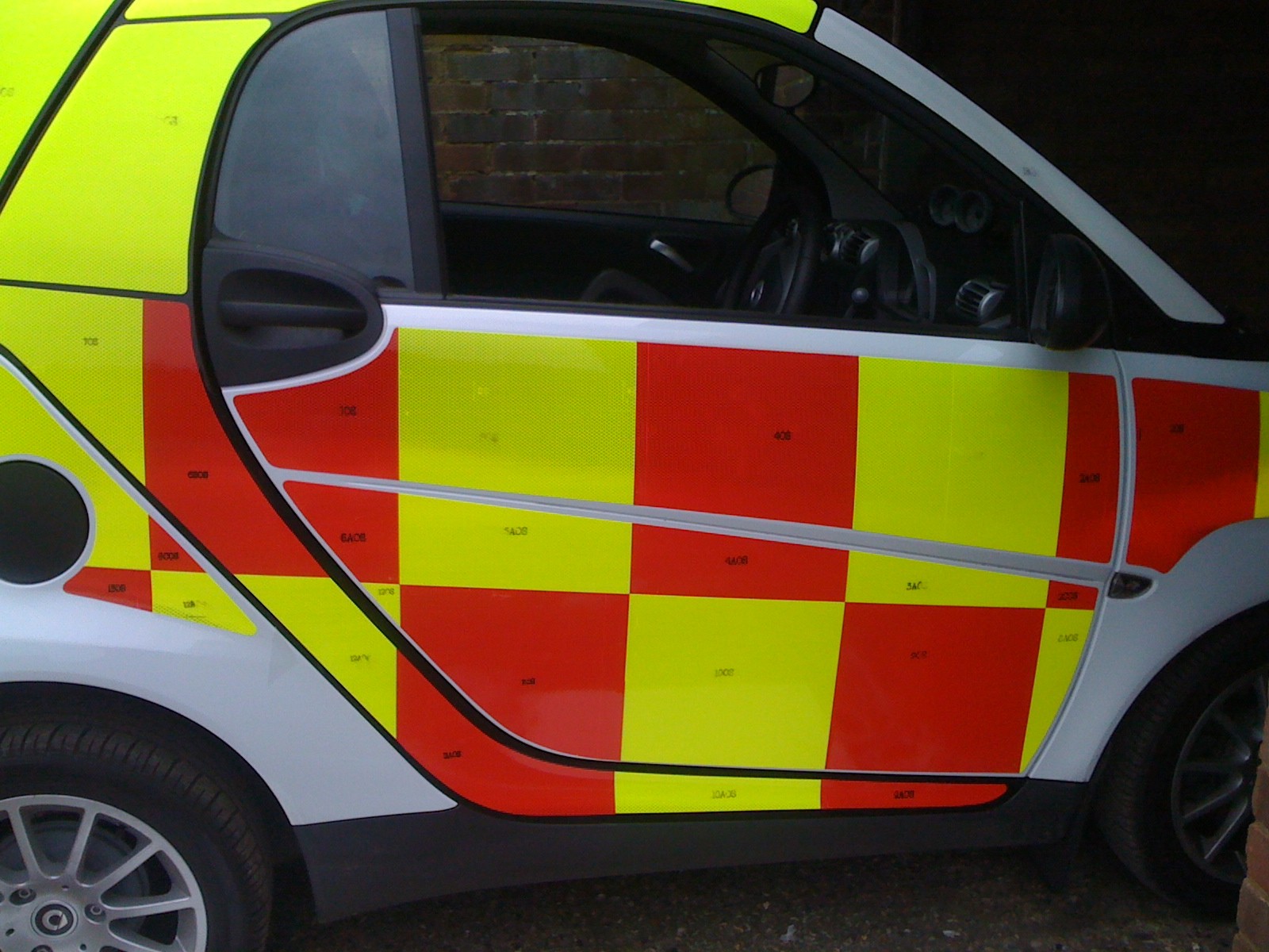

  • Chris Windebank
    19 March 2011 at 08:27
    as Peter has already said, Bluelite are good. Here is a kit I fitted a while back. Took 2 days to make and deliver to me as a kit.
    There is a template that comes with the kit and notice the numbers printed on the parts to show where things go
