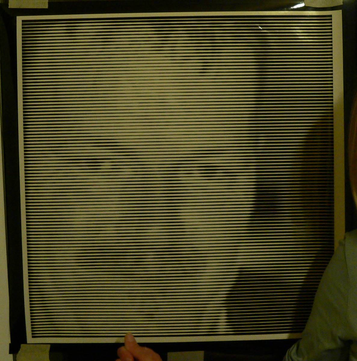

Posted by Peter Normington on 16 December 2008 at 01:29its a bit old hat, but stuff like this is possible from cut vinyl

Paul, weeding is very easy, I just do the cut with a border and the whole lot comes off in one piece
Peterl
quote Paul Humble:Great work, isnt weeding it a pain though Peter?

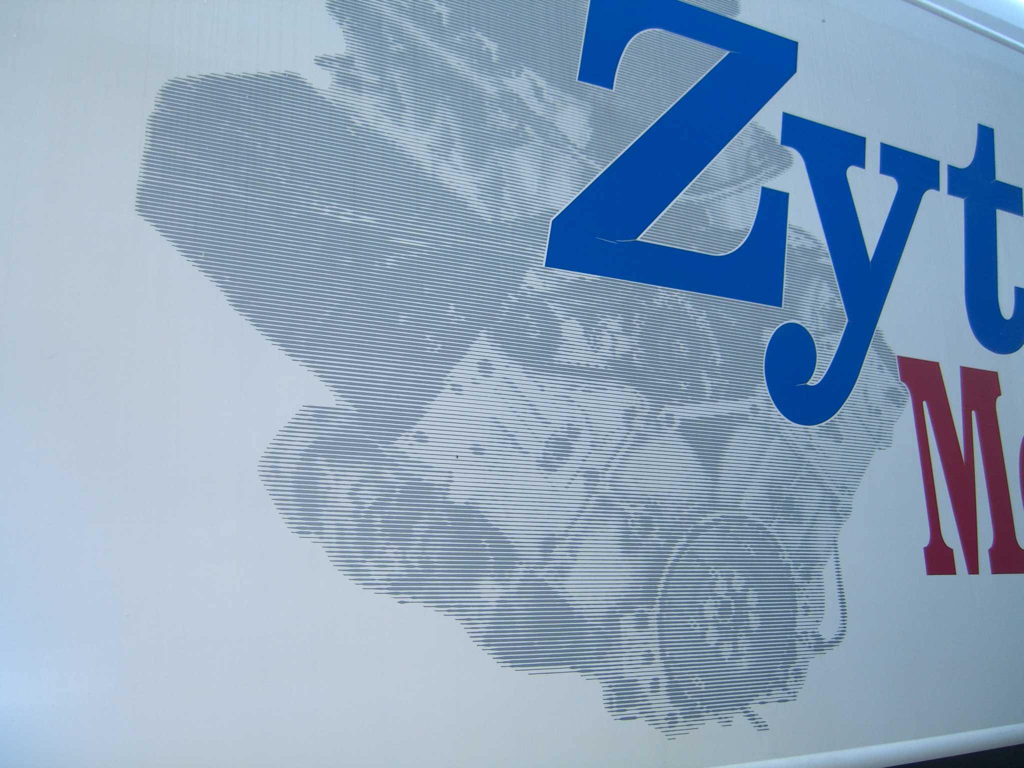

I used to have a bit of software called Photocut which would do that. It was DOS though, so no chance of getting it working today.
The image was made up of lines of varying thickness, a bit like the old 405 line black and white television sets. That way there were no small fiddly bits to weed, just grab hold of one end and pull the lines away. A matter of seconds.

Hi Peter,
that looks really good, i had done a similar thing but with halftone dots, they were very hard to weed and the image wasn’t as clear as yours.What did you use to create yours? I went through this thread and couldn’t see weather you mentioned the software you used to create it?
Liam
quote Peter Normington:found this Alex
http://project5.ghcentre.com/samples.htmThat looks very much like an updated version of the software I used to use.
If so, Alex, it takes a bit of practice to get the best out of it, but worth the effort.
quote Liam Pattison:Hi Peter,
Liam
It was done in signlab,

Thanks Peter,
Jon, how is this possible in flexi? I know there is a stripe feature, but i didn’t realise there was anything like this. I have been through the instructions and couldn’t find anything?
Liam
Thanks Jon, that’s guided me to the right page in the the instructions. Will be trying this out.

Peter,
What version of signlab did you use and how is it done? -
James I have print and cut
the photo cut is one of the scan tools, I think it is in all versions of signlab from at least version 5.
