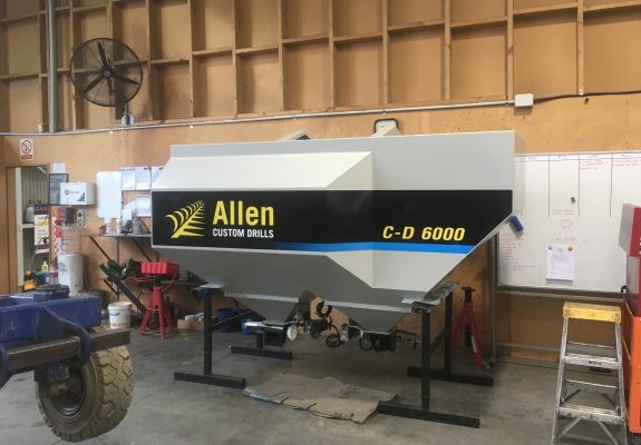

    I do a lot of large decals for agricultural equipment, which involve some fairly close registration with the machinery, with rounded corners and sometimes quite complex shapes. I use 3M printed wrap vinyl without any application tape.
    Perforation cutting is a godsend for this job, its really easy to line it up, hold it with magnets, and tape one end, then work down the length with a felt squeegee. Both sides of this bin took about 40 minutes to apply for one man. Its about 3 meters long.
