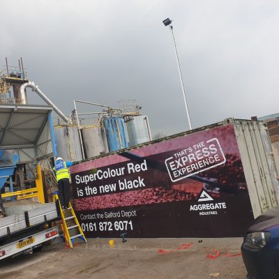

      Here’s the job installed

      9 May 2022 at 11:46
      I was surprised how quickly it went down, if you look at the photo closely, we put the overlaps in the middle of the boards then trimmed between the two panels, much quicker and no issues with alignment when fitting.

        do you mean it is fitted horizontally along the length of the boards. so two big long panels?
          9 May 2022 at 12:05
          No they’re vertical drops.
          Rather than covering each panel with 1 drop of vinyl, we staggered them so that the overlaps fall in the centre of one board, and spans the join of the two.
          Just makes life easier when aligning the panels, another sign maker gave me the idea.
