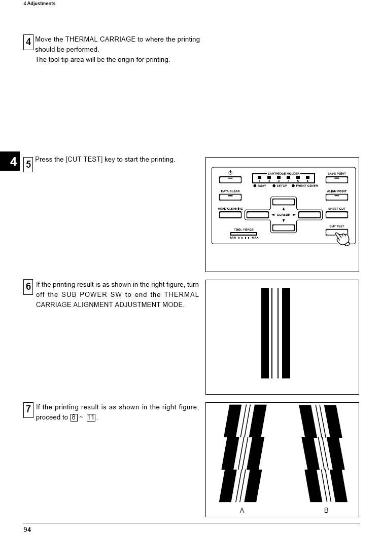

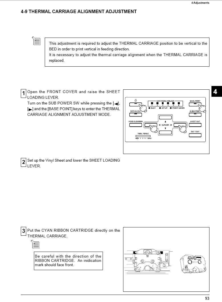

    You will need the ST-042 special adjustment tool and the following instructions.
    Have fun,
    Alex.

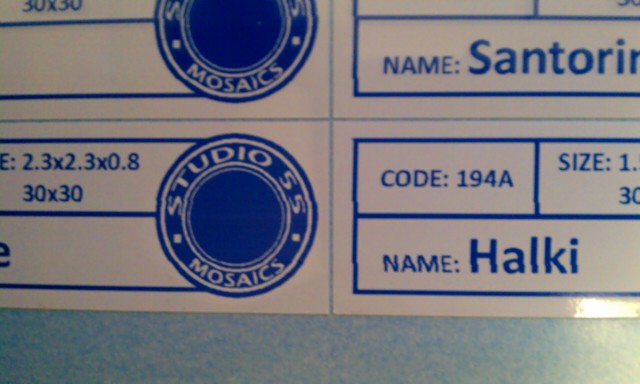

    17 January 2011 at 13:01
    Thanks for that, ive just set it up and got it printing bang on registration. I didn’t have the tool but found I was able to turn the screw with the tip of a scalpel.
