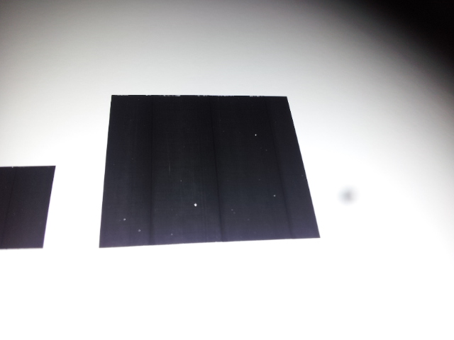

Posted by John Radmore on 6 April 2014 at 19:42Hi, i have managed to get the pc60 printing and cutting thanks to some previous posts on this forum. I printed a Black square to check for lines. I can see a line where the print over laps. There is no print missing on these lines and if you look at it from a distance or a different angle it appears to be a solid uniform colour. My question is, is the Head in bad shape or is this normal to see overlapping when you look closely. The machine did come with spare print head but i don’t know if it is new or not. Any help appreciated, John

Hi Chris, i am printing black onto a standard 3-5 year White vinyl which is probably not the ideal media for the job but i am still trying to get it working well before i buy a lot of the good stuff. i have tried to attach an image which shows the lines i am referring to. I’ve had no luck using google to locate a pdf version of the service manual. I have seen a number of old posts on this forum where people seem to have a pdf copy. I appreciate that when using entering the service mode i must take care, thank you for the heads up. can you see the lines in the image? many thanks, John

Difficult to make that out but poor ribbon alignment or the small black roller degrading. Or poor ribbon
need better pic
If you wind the ribbon back so yoan see where it has been used and should not be close to the edge. When the ribbon is out of alignment will leave a faded edge in the print -

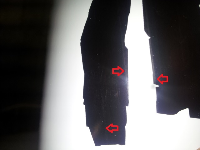

Ok, i checked the ribbon and it was not near the edge, it also was not faded where the black ink had transferred. i have now installed a new ribbon in a different cassette. i would say it is slightly better but i still see a very fine line where i assume it is going over itself. i have taken another pic which seems clearer. Thanks for your help.

That last picture looks just like the common banding to me. You can always tell a print of a pc60 by that banding, you will never get rid of it.
