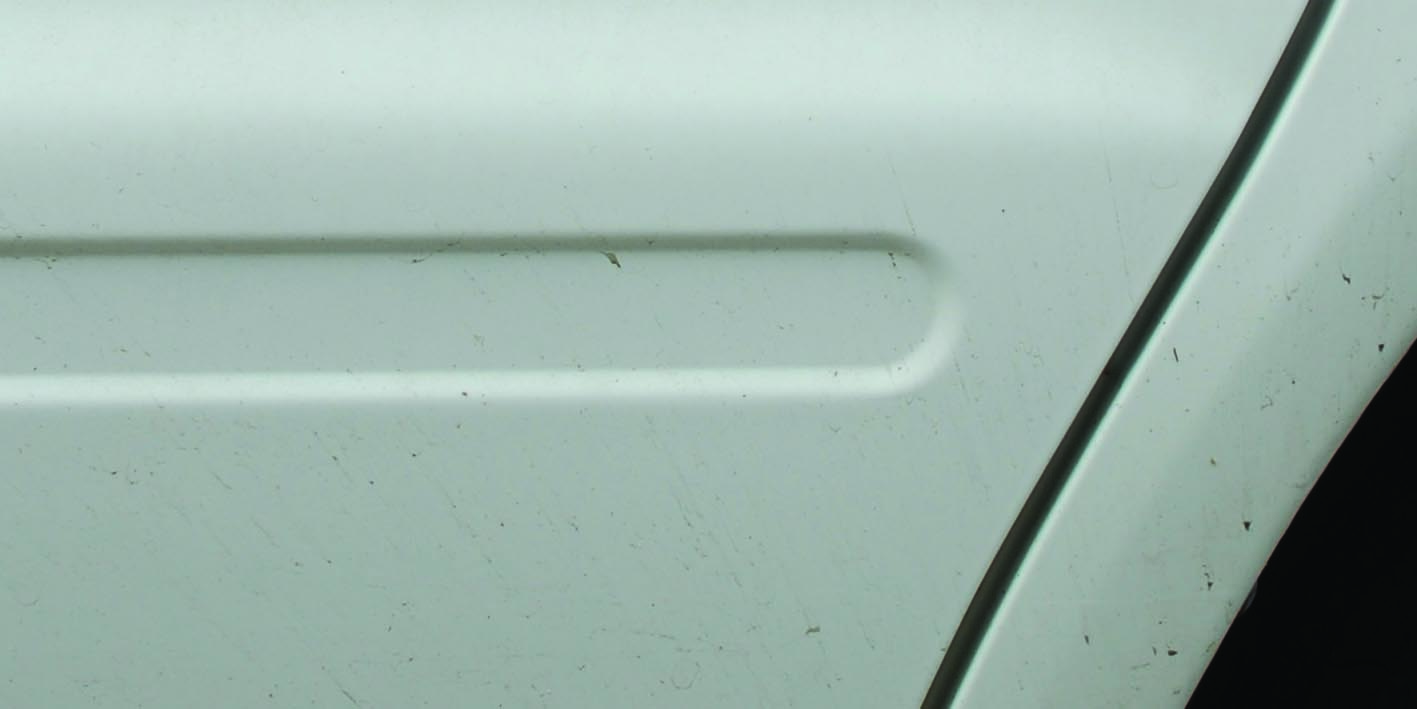

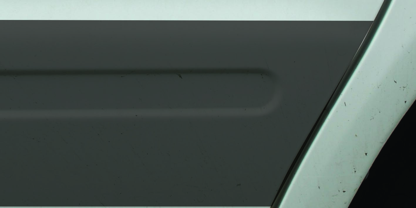

    Here is a picture of the rail/dip running down the doors and we need to wrap over this rail/dip! Hope this makes sense??
    We are wrapping from the bottom to half way up the car
    thanks
    Dan
    van 2 is like the finished product if that helps!

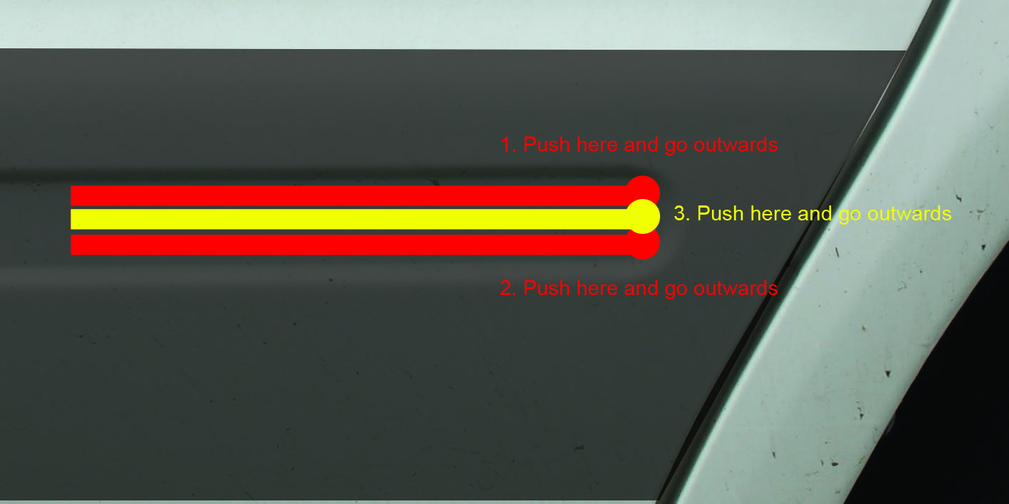

    After your sheet is applied you will use a heat gun or torch to heat the vinyl. When you heat the vinyl you will see it ripple then flatten out. Once it does this is hot enough. Let the vinyl cool for a bit and use your finger wearing a glove that is a bit wet on the tips of your fingers to push into the groove and out wards. Make sure the air has somewhere to go. I like using vertical panels because usually I have an outlet for the air to get out. If your using your finger don’t push but drag your finger so your forcing the air out. If you push instead of drag you’ll more then likely end up with small creases. If the vinyl is still too hot you will end up with small creases as well.
    Also make sure your applying enough pressure so the vinyl is fully down with no air pockets. You really need to press down with your fingers to ensure all the air is out. If you leave some air behind and then enclose this air you will need to release it with a pin tool.
    I’ve attached a picture of what I mean.
