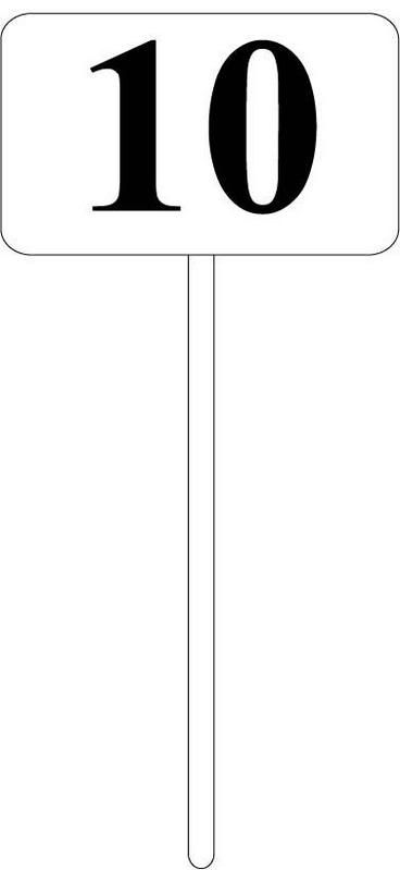

    Hi All
    Looking for some ideas please.
    I need to make small signs to hammer in to the ground, about 600mm high with a small plate with a number on it to indicate which flat’s parking it is.
    A rough drawing attached but need some ideas of materials and manufacturing.
    I know it’s a simple one but thought I would see if anybody had some bright ideas.
    Warren

    Warren
    if you have a grafityp brochure they do a product called stikit signs.
    I cant find them on their website, but they may be what you are looking for? Not a 100% vandal proof though

    temporary or permanent Warren ??

    just re read…sorry….. hammered in so temporary

    Why don’t you just rivet it to a 25mm box square or right angle aluminium –
    we used to fit them all the time like this.
    Hope this helps

    I did think of those Peter but the customer wants them quiet high and also not so big 😕
    Thanks anyway mate

    Hi Mark
    That sounds like a quick, simple and strong long lasting option.
    Thanks mate

    I’d agree, it is a good option, we also cut the bottom of the angle to 45deg to make it even easier what whap into the ground.
