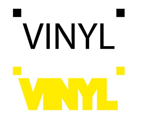

    This is a good trick – same boxes on both vinyls and line boxes up, works with outlines, shadows the lot!!
  • Simon Worrall
    30 July 2021 at 06:16
    What Craig says. Way more accurate than trying to eye through the plastic tape.

    craig, I am unsure what the squares are for. but guessing they are to line up the graphics.
    but how do you line them up easier as you are still using the paper tape? sorry if I am not sounding very clever. 😳 its nearly the weekend though so I am chilling today. 🤣❤

    Leslie.
    Say you have red text with a yellow outline on your screen in front of you.
    1. Draw two squares above the design, above left and above right.
    2. Colour them yellow.
    3. Copy them, and then paste them in place.
    4. Colour the new ones red. You now have two red squares in front of two yellow squares above your design.
    5. Open the design in your plotter software.
    6. Plot all the red. Including the red squares.
    7. Plot all the yellow. Including the yellow squares.
    8. Weed and app tape
    9. Cut out the graphics along the top edge of the squares on both the yellow and the red vinyl.
    10. Place the yellow vinyl on the substrate and squeegee. Remove the app tape
    11. Line up the two squares of red in front of the two identical squares of yellow. Tape the graphic in place. If you have done it correctly the rest of the graphic will fall exactly in the correct position (register). Squeegee and remove app tape. Now peel off the squares and dispose of them. They have done their job.
    I am sure Rob will now say it better than me, and also fill in with beautiful diagrams!

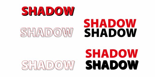

    30 July 2021 at 12:22
    If it’s small registration marks work a treat, however I’ve found they don’t align 100% on larger blocks, I’ve never been able to put my finger on why this occurs.
    I know it uses more vinyl, but one one particular job we use the same size weed border.
    Trim the bottom layer to the weed box, tape up the top layer and trim to the weed box, align the top weed box, with the release liner (that’s trimmed to the same size) on the base layer, and TaDa! It’s all ready for installation.
    If it’s a shadow on text I also ensure the shadow includes the same shape as the top, rather than just the shadow aspect, image attached. We do the bottom style, so gives you additional points to register the text to.
