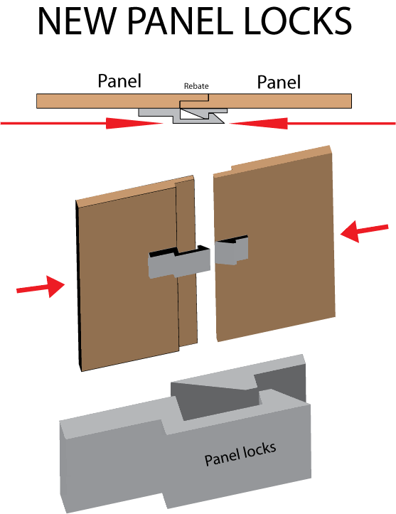

I know a few but would like confirmation as well as advice on the panel locks I would need to use, these ones below have a rebate area which I am not sure how to make.

Warren use a router to make the rebate, an alternative to panel locks is a flat metal spring plate that is located in the two ends of the frame to keep the panels pushed together.

why do not need the rebate on composite board-dibond with panel locks?
im maybe not thinking straight here but ide iamgine you wouldnt need them here.
a hand held router is all thats needed waren, get them from b&Q from about 20 pounds upwards. you will need a flat head bit for the rebate.
im guessing these panel locks are from sign makers products? seem a good system, i have some samples i have yet to try out, but will iin my return. ive been sent LEDΒ΄s and panel returns also to review…ok 3 minutes left… π :lol1:

Yes they are the ones from SMP, I know you can’t answer me now but are you saying acrylic with a rebate is the best option?

[ If you have a deep panel you can glue pieces of the same material to the back to form an interlocking tongue and groove, so the join is not able to separate. and at the same time forming a rebate (only really needed for foamex as it bends easy)
Warren, rebates will be needed for light boxes, as panel locks or any other method that adds material will show through when illuminated.

I understand about the spacer but where about do they go? along the top and bottom edge to keep it flush with the frame?
I’m not quiet getting the rebate and panel lock options yet π sorry, normally these things come quiet easy to me π³ As it is not a light box what is the easiest method?

Which part of the rebate’s are you not getting ??
Is it how to make them or what are they for ??
Hi Glenn
No, it’s whether or not I need them and what other options do I have.

the reason for a rebate or panel lock, is to stop the wind getting behind the panel and blowing it our, Phil and Andy will say they are not blown out, but sucked out, it amounts to the same thing though.
so it depends on the depth and material if you need to use one, both or none of the methods
Its always a good idea to keep the joins together. so springs are my first choice
Dibond is not really suitable for and don’t need for rebates, -

If I use 5mm acrylic (non illuminated) what route should I take to join the 2 panels?
I can insert from the side if that makes any difference.
