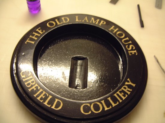

    I know this won’t even come close to what some of the tradional signwriters do on here, but this is the first time I’ve been paid to do a hand-painted sign and I’m just really chuffed with it 😀
    I made quite a few mistakes, one of which was using cheap brushes (having to dig brush hairs out every 2 minutes) and I started off using the wrong paint 😳 Enjoyed making it though 😀
    Cheers, Dewi
    Edit: I forgot to mention, the indent in the centre is for a brass miner’s lamp, I’m hoping to get some pictures of it when it has the lamp in place 😀

    😳 😳 I actually started with Hammerite 😳 😳 I just thought it would work okay and give it a hammered gold look, but it just looked aweful. Luckily I’d only done a tiny amount when I realised so off I went to search for some enamel paint as had been suggested to me on here.
    I ended up using Japlac gold enamel, which is very liquidy and it seems to dry very very quickly. Alot easier to use though and I’m really pleased with the finish.
    Like I say, I know its only simple lettering, its just I’ve been itching to do a real job with paint so I’m over the moon now I’ve finally done one 😀
    Cheers, Dewi

    Yep, used the Oracal paint mask that Nik sent me a while back, then touched it up by hand once I’d took the paint mask off.
    It dryed very quickly, about an hour, maybe a little more. When it was coming off though, there were bits that needed sorting as the mask took off some of the edges. Whole thing from start to finish was a couple of hours, most of which was the drying time.
    I really want to try some more painted stuff now though, it gives a different buzz than when you work with vinyl. The fact that I could add a little swirl on the R, and the different textures of the paint on paint, just looks so much better than if I’d slapped some gold vinyl on 😀
    Cheers, Dewi

    Mort – from my own experience of paint mask, lift it when the paint is still wet, when the paint dries the paint grabs the edge of the mask and comes away in lumps along the edge, the last one I did I left only for 10/15 mins while I had a coffee before removing the mask.

    I possibly left the mask on too long then, it lifted edges of the letters, hence the retouching to finish it off. But it felt like I was a signwriter for about 30 seconds, so I wasn’t complaining :lol1:

    I always take the mask off when the paint has gone tacky, If you lift it when its wet you can cause strings of paint which drop and make a mess and as you have said leave it too long and the paint forms a skin between the mask and substrate and pulls the edges.

    I was quite surprised at how quickly the paint dried though, how long does it normally take to dry?
    I’m considering using the same method to add some text to the outside of my shop, apart from the fact it looks quite good, its fun to do as well.
    I’ve had a couple of goes with spray paint, mainly spraying over clear vinyl that I’ve printed on and although it looked good when I first did it, the spray paint I used dried rock solid and cracked when I tried to apply the sticker 😕 I’d be interested to know what type of paint to look out for to paint vinyl and other stuff.
    Also, the brushes I used were rounded and came to a fine point. Am I using the right type of brushes for this type of stuff, or should I be using the flat kind? Whats the difference/uses for these brushes?

    bet you feel great doing paint… 😉 anyway brushes flat head ‘chisled’ are one-shot for lettering they hold more paint (ed’s department) 😀 and i use them also for filling in large letters on banners, the thin ones are for lining and smaller lettering 😛 😛

    im with the others, when i ink banners and that kinda thing with a stencil vinyl, i remove when tacky. as has been said you get strings lifting wet at times…
    if using a mask vinyl i always heat the tencil and rub down firm because sometimes paint or ink tends to bleed under the vinyl if you dont have it on properly.

    Dewi if you want to use spray cans for fade effects on vinull use Humbrol. Remember Humbrol is formulated for plastic models. Slightly scuff the vinyll and spray from a low angle, never had any problems with adhesion in over 10 yeard using it. Oh forgot to say spray before you weed the vinull.

    In short NO. never had to clear coat. the sign I posted has been outside for well over a year and is still good, also did the van the same way and thats has been though the car wash many times and again is still good.

    I’ll look out for the Permagild Jill and I think I may have to invest in some half decent brushes. I bought 3 packs of (what I thought) were reasonable brushes, variety of sizes and shapes, but I hadn’t accounted for them loosing bristles with every stroke 😕 I did enjoy it though, so its well worth a couple more quid for some decent ones.
    Paul, thank you for the advice with the spray paint. Again, I picked up a variety (albeit the cheapest ones 😳 ) but I’ll grab some Humbrol and have a lash about 😀
    Outline, I know, even with the lettering, it still looks like a bloody ashtray :lol1: Can’t wait to see the lamp in it, at least I won’t be tempted to put my ciggies out in it :lol1: And yep, used CorelDRAW to do the layout, took me a while to figure out how to get the lettering to look right as the path tools in CorelDRAW aren’t the best in the world. Let me guess, Flexisign does it better? :lol1:
