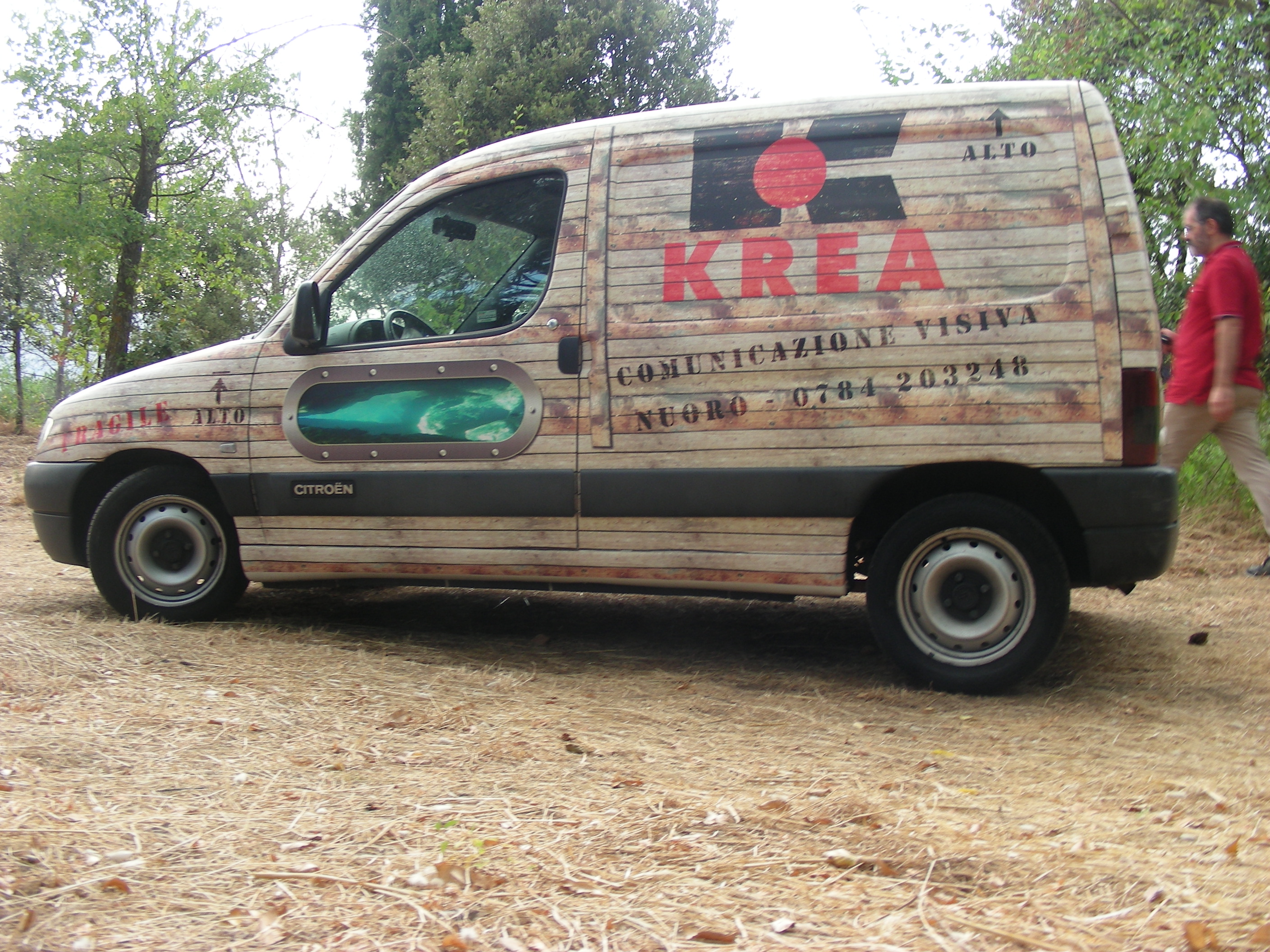

  • Terry Bull
    6 February 2008 at 18:57
    good work ,eye catching and legible
    i should imagine they re not a very good shape to wrap and you have done well to keep the lines constant

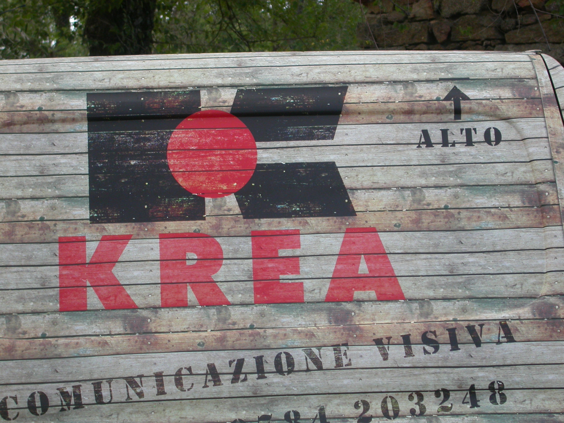

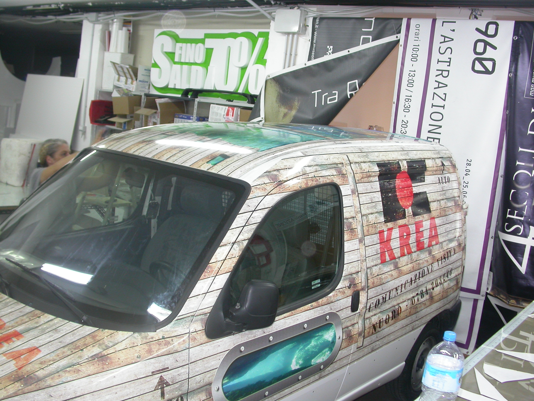

  • Gian Gavino
    7 February 2008 at 09:41
    HI
    I am pleased that like. 😳
    I was five years trying to decorate or not I liked drawing, or I did not have the time to do so.
    (-) Then one night I dreamed of and the day after the printed and applied.
    And now I hope it brings labour, here we are a small country, and little money.
    The work was simple: I went from carpenter. :lol1:
    I used Imageperfect material distributed by spandex.
    Cast 2507
    Printed with mutho ecosolvent
    Rolling liquid applied airbrush after applying the press.
    And seven sweat shirts.
    19 M2 print
    1.5 M2 wrong
    1.5 M2 scrap
    Gavino
