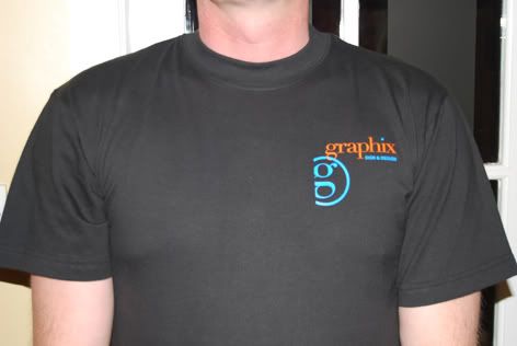

    at a Tshirt.
    As you know John has been keeping you posted about our recent purchase. So tonight we thought we’d put it to the test and see if it was all working properly. So here’s our first T.
    Everything seemed to be working as it should. 🙂

    1 June 2008 at 18:40
    looks good marcella… nice one… im guessing thats a cut vinyl type lettering pressed up? has john tried any mugs yet?
  • John Thomson
    1 June 2008 at 18:50
    You are right Robert……cut Xpres vinyl……….it will take a little while to find our feet with this but I am sure we will get there………..I ordered some flock as well.

    Did you do know you should be using a 60 degree blade for cutting flock?
    just thought Id ask, as not everyone starting out knows.

    How small can you reasonably go cutting flock?
  • Calvin.Turner
    2 June 2008 at 20:43
    Glad its going well so far 🙂
    smallest I’ve managed to realistically get with flock is about a 1mm square dot over an "i" i’s and such are a pain. Can go smaller with flex though but needs careful weeding. Some fonts are obviously a pain – my company logo uses Niagara engraved which is impossible to get small enough in flock for a pocket logo but I just dont cut the middle bits out and its fine. I can do it in flex easily. Its a shame flex isn’t as un sticky as car type vinyl as its a pain to weed.

    Looks good but I think you cut a bit off the ‘g’ and the circle. Otherwise, great
