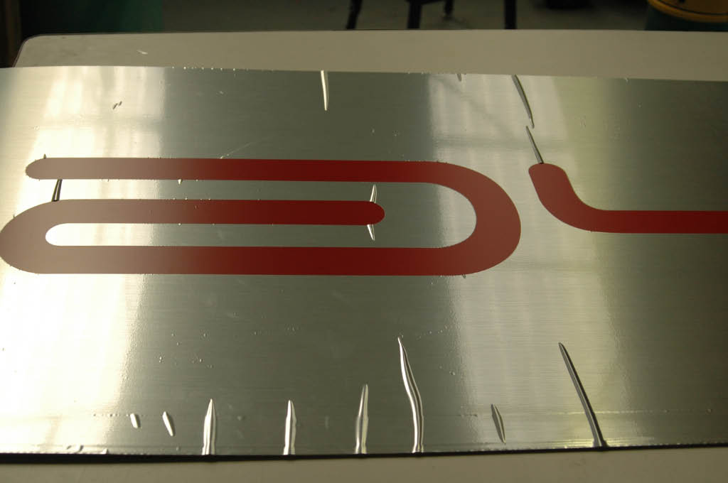

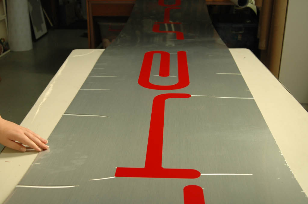

    Just did a job earlier this week, laying translucent over perspex, and then putting a metalic mylar over the top with cut out letters, so olny the translucent colour shows thru.
    It failed overnight.
    Took it up with Graphic Art Mart here for a claim. After a couple of days, they get back to me to tell me the claim is void because the Avery Website has a pdf advising against using it on perspex. I asked how I was supposed to know that the pdf was available, if I didn’t know it would be a problem.
    They came back to say that they had a ‘tip’ in their newsletter several years ago, and that as I was told in that newsletter, they are not obligated to correct my error. My response; how did you know I got that newsletter. Answer: he didn’t.
    So, my argument is that no one informed me this was not possible with the product, so they have some responsibility here. Its not mentioned anywhere in the new price list that the product has limitations either. They’ve washed their hands of the whole thing.
    I’m pretty cranky about the whole thing in truth.
    Another reason why they don’t deserve ALL my business I guess. 👿

    Shane…not that this is going to make any difference to you….. but is the mylar stuck to the translucent vinyl or directly to the perspex??
    3 October 2007 at 07:16
    quote glenn:
    stuck to the cast translucent. Applied dry. (6m x 700mm – no joins)

    No the stuff was stuck to the translucent, but they claim the perspex is probably out gassing, and whilst this does not effect the cast translucent, because it breathes, it does effect the mylar because it doesn’t breathe.
    The pdf’s just make a blanket statement not to apply it to acrylic or perspex. So technically, no matter what is under the mylar, it is still applied to the perspex.
    My argument is, that nowhere on any documentation, either the invoice or price list, does it state that it can’t be used in this manner.
    I still think they have to take responsibility for this.

    surely perspex materials, like car paints etc, will only outgas for a short period of time, and i doubt you picked your material up from the local perspex works at the end of the road, so i’d figure it’s done al it’s outgassing by the time you get it.
    i was also gonna ask the same question about how can they turn it down, as it wasn’t stuck directly to the perspex, i guess you’ve kind of answered that, but their excuse is extremely lame !

    In my own defense, I’ve applied mylar to perspex in the past, but it was old perspex, granted, and it is probably the reason why I didn’t think of the out gassing theory. That said, the perspex was in my office for a week before I signed it, laying on its edge as they insist for out gassing, so I’m not sure that Graphic Art Mart are being totally honest with me. Frankly, I think they are clutching at straws to void my claim.
