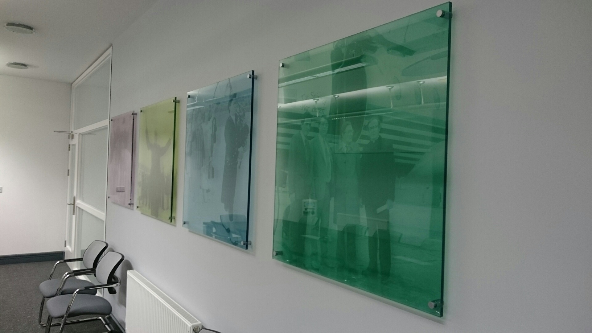

    I just got 3M 8150 Optically clear in to do this job. I actually printed with latex but it’s ok with solvent too.
    It really is glass clear. Wet application is recommended.
    My only issue is that if you wanted to laminate, then the laminate is not glass clear!! Seems to defeat the object somewhat! :rollseyes:
    I didn’t really need to laminate as it’s obviously indoors & reverse print fitted to the back of acrylic but I actually have to reprint one panel which got a very small scratch!! 🙁
