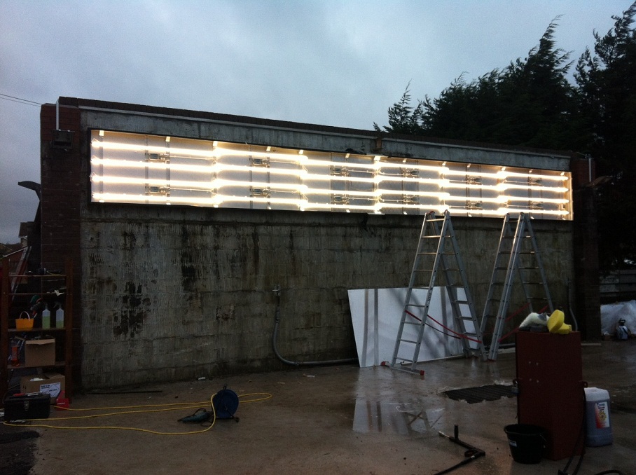

    I did a 10m x 1.1m box a few weeks ago.
    Was 24 tubes in total. (see pic) and nice & bright.
    To be honest, I wouldn’t MAKE a box no matter how cost conscious the client is…buy it ready made. Takes all of the hassle out of it.
