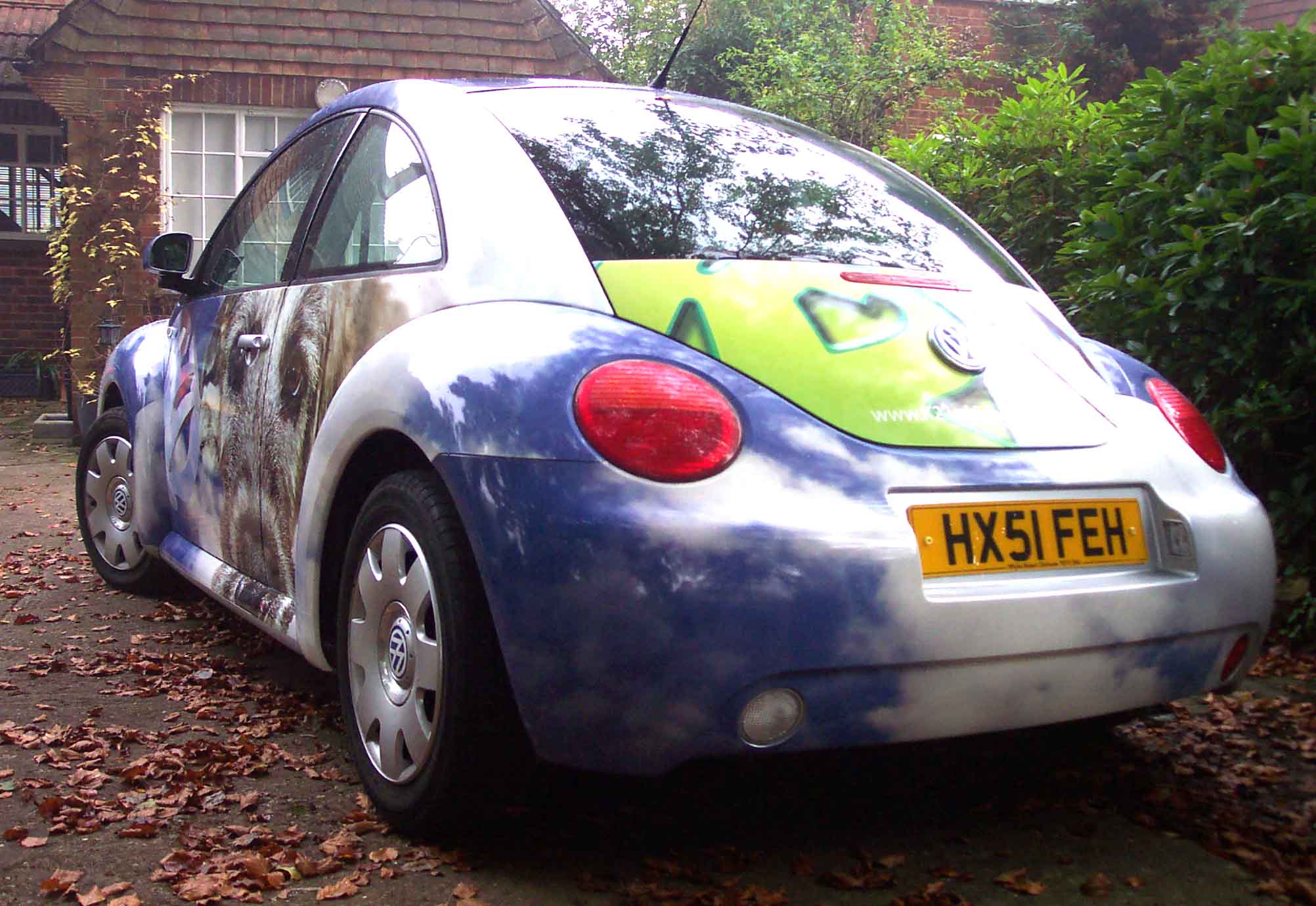

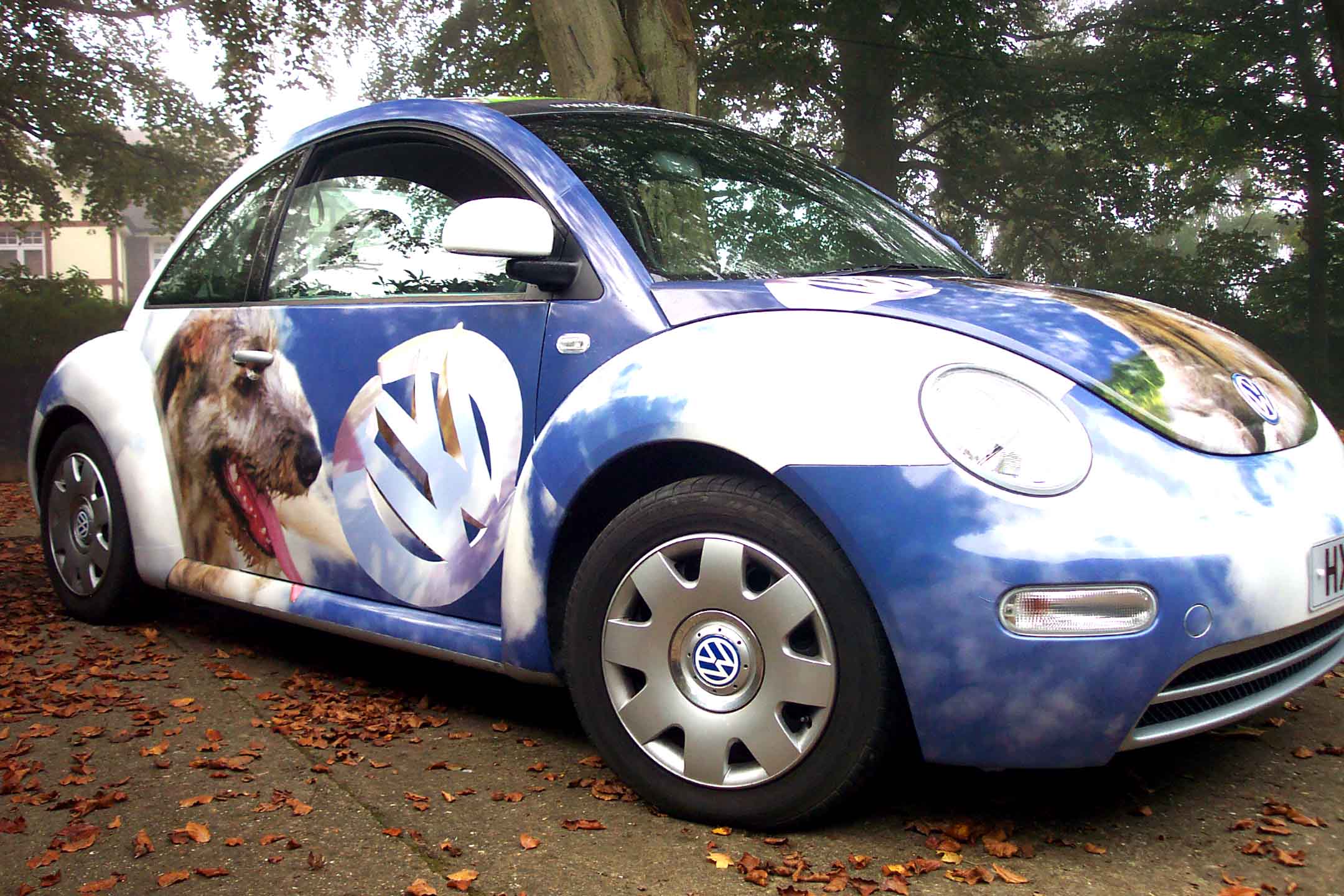

Posted by jason-price on 27 February 2007 at 12:44so, (lol) my mum went on hols to spain not so long ago, and she got a nice new irish wolfhound puppy just before she left, and asked if i could do a little sticker for her beetle.
i reckon that will be last time she will ask me to do ‘a little sticker’ eh
jas
ps the beemer was black!!!

Nice job,
Shame you cant get VW to reimburse your costs for some pretty snazzy advertising…….
:lol1:
cheers for the comments all!
but, beware if anyone is planning to do a new beetle, hardwork! bigtime! not a flat surface on it!

blood sweat and tears!!
as for the front arches, its quite wasteful, as the amount of bleed req, but i start from the rear (thinnest) section and work forward, trimming in at the part where the wing meets the front bumper, alot of heat and forming required, and a small amount of water with johnsons baby shampoo in it will help stop it grabbing too quick.
hope that makes sense! (it did in my head!)
