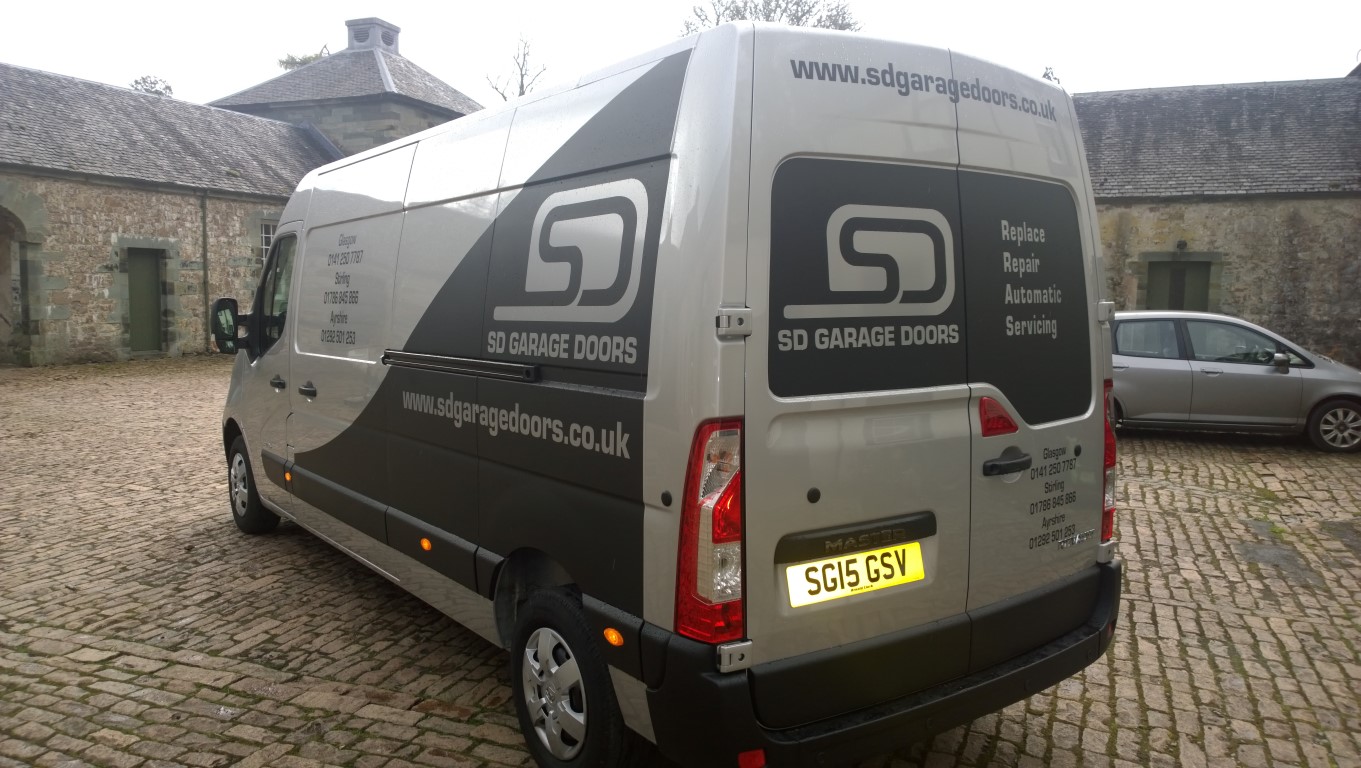

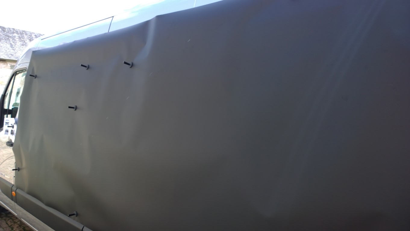

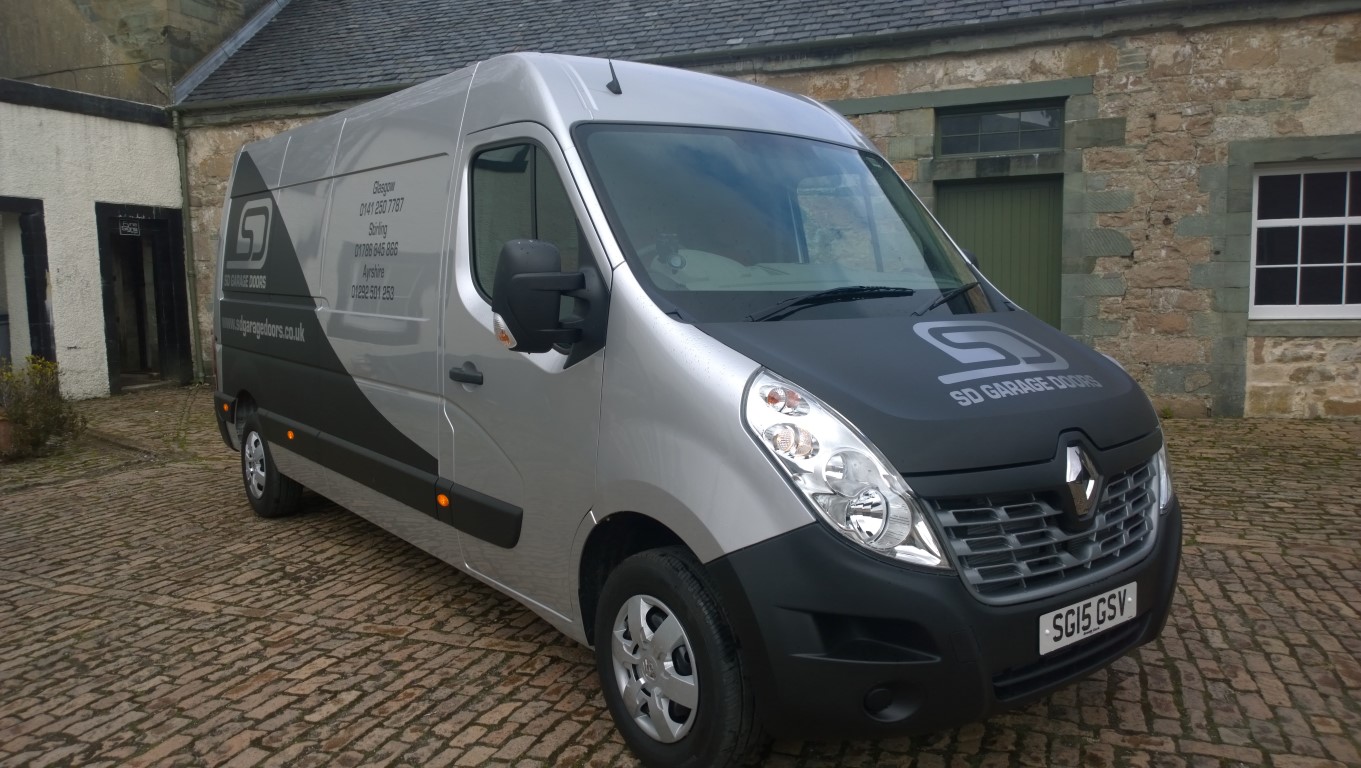

    Ok, here we are. How did it go? not too bad i think for a first attempt. Few small errors, probably over heated a few bits, over stretched a few bits BUT i did make sure everything that needed it was post heated.

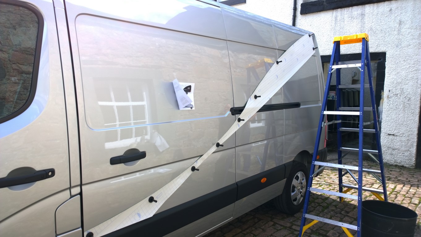

    Now before i get lynched, i know it’s outside but in my defence, i don’t have indoor space and i did constantly check the panel temp, which thanks to the weather stayed a pretty constant 19 degrees. Biggest problems i had were trying to do the first side in one go, i soon learned that was too big and did the other side in 3 smaller panels. The first photo is the template i cut to give me the line, this was held on with magnets the the wrap cut tape was applied along this line. The other side was a simple case of reversing the template. I’ll use this method again. Next up is the one i tried to do in one big panel. In hindsight this was madness for s first timer. 3.5m x 1.5m was just a bit too ambitious but to be fair i got there in the end. The bonnet was a doddle after doing these big panels.
    It was then finished off with Oracal 651, silver grey and matt black.
    You might be asking why i didn’t take the wrap round the corners at the back? This was one of the compromises i had to make to keep the cost down for the customer, plus it was mates rates so we both wanted to keep it fairly simple.

  • Kevin Flowers
    27 April 2015 at 10:29
    Hi
    nice work Ewan, just one criticism why use a mono meric vinyl on top of a expensive wrap vinyl. The monomeric will shrink and leave a horrible glue line. Hopefully won’t effect the wrap vinyl but would definitely advise in future jobs that upgrade to cast vinyls
    But as i said nice job
    Kev
  • Ewan Chrystal
    27 April 2015 at 10:35
    That never even crossed my mind Kevin, however 651 is polymeric not monomeric
  • Kevin Flowers
    27 April 2015 at 10:54
    Yeah Ewan you are right but it only just scrapes into the range used 551 and 751 successfully for years but as said i would have gone for matching brand and quality. I know some will say they mix all the time but for pennies saved why have the risk of a problem one day.
    Kev
  • Ewan Chrystal
    27 April 2015 at 10:59
    Point taken, something to think about for the next one, thanks, all hints and tips taken on board
