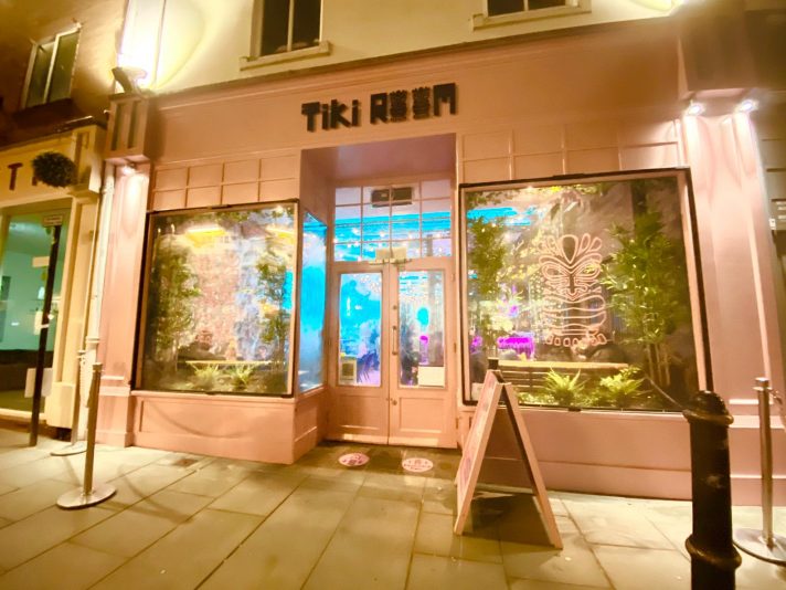

Cheers Kevin, looks good. Where are you buying it from? All the “name” suppliers seem to only be interested in making the sign for you whereas I want to buy strip, driver, clips, etc separately and at the moment e-bay seems to be the only place doing that…?
Hi Martin, I got them Citi Led, ask for Khalid, really helpful guy
Wish I could get it in NZ. I have a job for it. Might have to import some. Those masks looks really effective Kevin.
What is the diameter of the tubes?

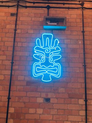

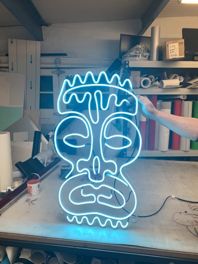

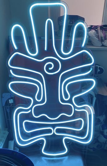

It’s a 6mm x 12mm profile, loads of colour options as well. Just a silicon sleeve over an led tape but easy to work with. There is a thicker RGB version available as well, will get some for a play around
Amazing look great Kevin, Did you router a channel out of the acrylic or did you glue/mount on the front or rear?
Used the laser to engrave a channel into the face around 3mm deep, then secured with micro zip ties. Took forever to do 3 different designs, definitely a cnc job but I don’t have one yet (soon, if I come to my senses & don’t buy my dream bike or the wife’s new kitchen) Wouldn’t do it like that again, outsource if you don’t have the machinery

Those look excellent Kev! Well done mate… 👍 -
Cheers Kev, citiLED an Aladdin’s Cave of goodies! Will post pics when signs are made – !
These are fantastic Kev!
I must give this a go. Thank you for the info and pictures.
