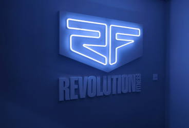

    A picture of another one I did, this time with some 3D letters and folded pan.

      Nice Robert. I also use this neon Flex material.
      Do you mind if ask. Do you router chanel out of your acrylic or foamex backing board below you lay in the neon Flex?

    Looks effective, illumination wise, but I have no idea what it is supposed to say or how to read it.
    10 September 2020 at 08:52
    It is their logo and we have had no input in the artwork. The neon is simply outlining the logo.
    they have other gyms, and this is a new one dedicated to cycle spin classes.
    This one is Revolution Spin – RS Logo, but they also use this take on their name/logo as “REVs”
    The other Neon and 3D letters is for Revolution Fitness – RF logo

    @Wayne-Maxwell
    I don’t router the channel mate. I use a very lightweight U-shape aluminium strip. screw it to the backing board and just slip the neon into it. if its exterior ide probably add a little blob of silicon here and there to make sure it’s fixed right. but what I use just now, holds great and easy to work with and do.
