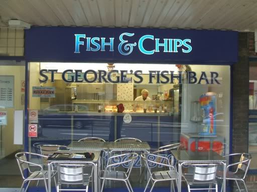

    Hopefully getting my first job for a light box but need some basic advice.
    I basically have to reproduce the picture below but with different text. I have been quoted for a light box and comes with opal acrylic.
    Is all the vinyl normal vinyl that will block the light and the white areas are bare opal acrylic to create the illuminated effect?
    Sorry for the "newbie" questions 😳

    Warren, Ive just ordered the bits for one of the smaller boxes. Again supplied with frosted acrylic. Im flood coating with translucent green and applying a heavier white for the text. Looks like you will be doing the reverse, however the text looks like its tinted blue in places, or is it just the picture?

    Warren, it looks like blue translucent lettering with a clear outline which would show the opal. You need to do something to prevent the background from illuminating though, as it looks non illuminated in the photo. I always use translucent vinyl on boxes because it doesn’t shrink like normal stuff. For the background, you could apply black first and then the dark blue but you’d have to be very accurate with registration. Even non translucent will let some light through.

    Graeme: one of the lights are out and it has created a tint effect, it is light blue (I think translucent) vinyl but the dark blue is total block out.
    Gareth: Sorry not sure what flex face is, this is my first light box 😕
    Andy: I hear your comments about registration so don’t think this is the best option.
    What do I have to do to make the dk blue a block out? Will I have to get it cut out of dibond or something and fit the acrylic behind it and apply the lt blue translucent vinyl to the acrylic?

    There is a way round the registration issue……
    Flood the panels in black. I mean solid black with no lettering cut from it.
    Then lay your cut and weeded blue on top.
    Then use the cut blue as a guide to handcut the black. Then weed the black.
    Piece of cake.
    2 April 2008 at 22:15
    Warren to make a total block out, you could use white digital block out vinyl, (it has a black adhesive) laminated with the darker colour.
    To avoid registration errors, just layer the 2 vinyls first then cut, easy peasy. Hexis and others do block out vinyl

    Another way round the registration issue is to laminate the blue onto the
    black before cutting, then set the blade a little deeper to cut through both
    layers. Bit tricky without a laminator though….

    I checked the sign today and the Dk blue is a vinyl, it looks like a Matt vinyl too. I could not see if it was done with a double layer of vinyl with the text cut out by hand, it looked like one layer of blue vinyl and it blocks the light.
    Besides getting this right I have to get this one to match that one in colour 😕
    Any suggestions as to what vinyl to use to do this? and what is the best way without the laminating option as I don’t have one.
